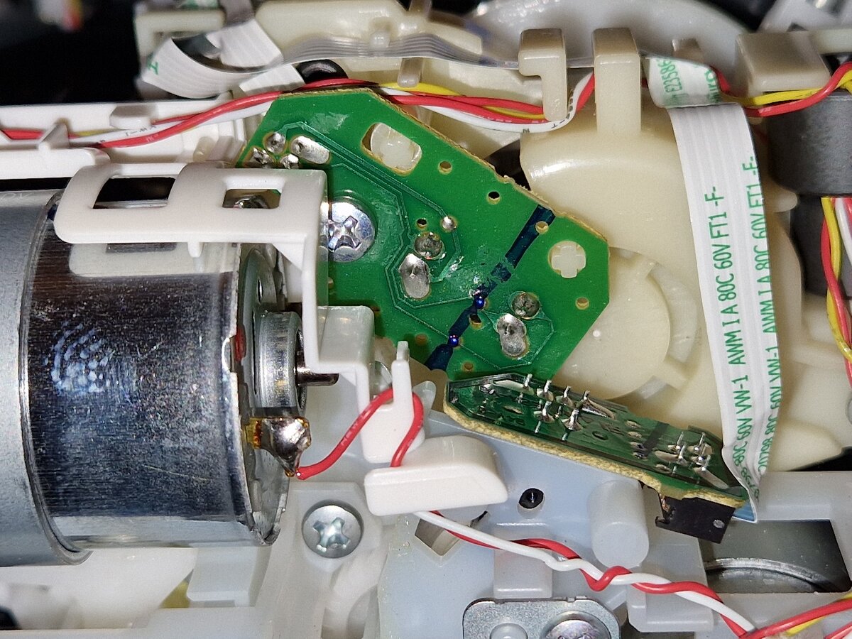

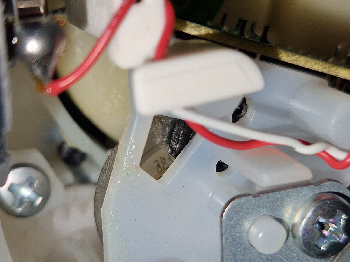

How did I brake my Pixma TS8350 by lubricating it?

I've never seen grease on plastic gears. If they were greased, they would be a mess of grease and dirt, but I've never seen one that isn't clean, even on an old machine. I sure wouldn't grease them.
That's a odd conclusion, and inherently false. Although grease is almost never a requirement for any mechanical system to operate, it is applied to prolong the lifespan of the parts against wear and erosion during use.
When applying a excessive amount or the wrong type of grease, it can become a mess.
With the amount of plastic toys I took apart as a kid, I can assure you that whenever there's gears involved there will be lubrication.

I too would never grease plastic gears..

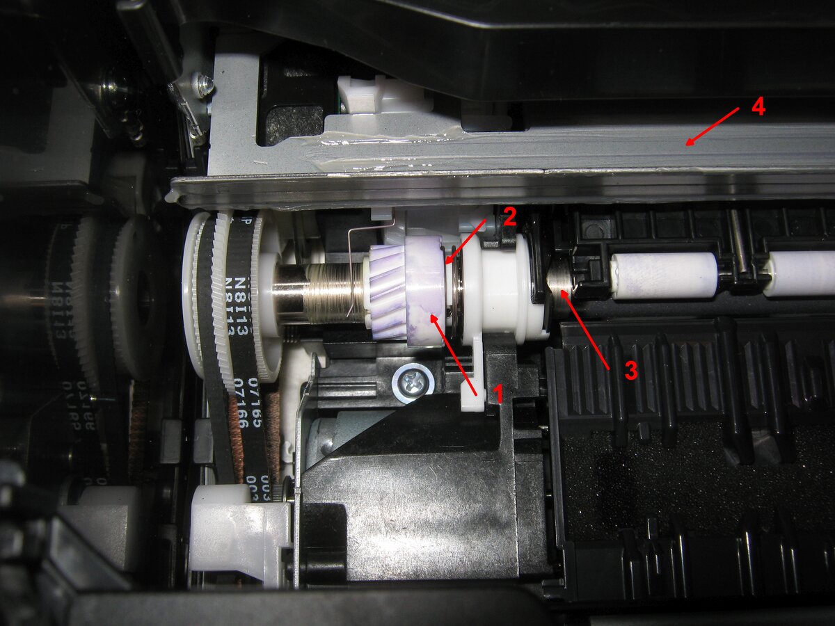

Notice that in the service manuals I linked to that sliding surfaces and maybe bearings are lubricated, but no gears.

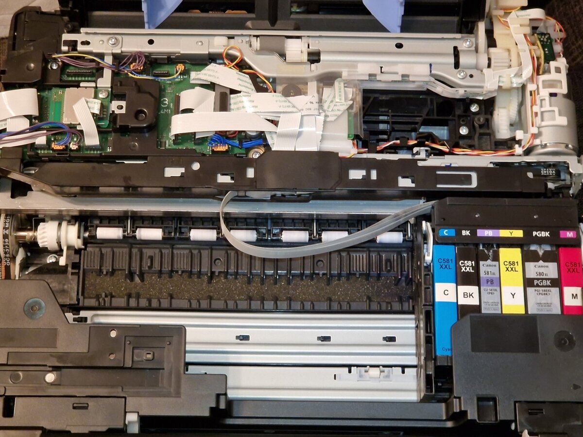

Here is a shot of the gears at the left hand side in a TS8250 that I think is similar to OP's TS8350. Notice the gears are not lubricated. The gear marked 1 is not lubricated but stained by ink or ink dust. A coupling slides at the side of this gear at position 2 this side is lubricated with a yellowish grease. The shaft appears to be lubricated at pos. 3. It might be a bearing surface. Maybe this can cause squeaking if dry? The printhead carriage slides along the rail at pos. 4. The rail is clearly greased.
I cannot test this printer as I have got no photo blue cartridge for it, but it doesn't squeak at start up. I'm looking for a cheap compatible one or just a CLI-580 PB chip, OEM or aftermarket. I bought this printer at a thrift store at DKK 62.50 which is less than 10 $ or €. I didn't notice that the cartridges in it were the 570 generation instead of the required 580 generation . But at least the wrong cartridges protected the printhead against drying out.

By the way, I have ordered the EM-50L lubricant and will try to add some to the right spots, and hopefully the squeaking will go away. Compared to your TS8250, my TS8350 looks almost identical on that side. Mine does not have that much ink stain, if any at all. It also has a yellow grease in all the places where it has visible grease, including on the left hand side in your picture, where that paper clip like thing is seen.
