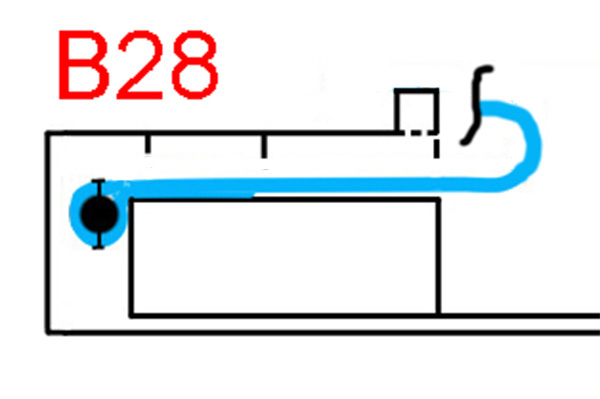

How do you overcome the head clearance problems with the 4950
while using the OEM cartridges and not the smaller CISS cartridges..?
16,179
9,132
aaa said:
I'm sorry, I do not know, what it is "the head clearance problems"?
http://en.wikipedia.org/wiki/Clearance
I was referring to the gap between the top of the cartridges and the printer body.
When you have the tubing attached to the top cartridges there is even less room.

The gap is about 5 mm. I'm using 3 millimeters. There is no problem. :)
5,250
5,155
Some newer Canon printers have a gap of only 1 mm. If you have one of these printers, you will need to cut the printer casing to make the gap bigger.

Tubes position on the right position cartridges, the printer is turned off.
