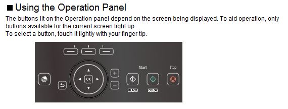

The MG6120 has got sensor fields instead of mechanical push buttons. Only the relevant buttons/fields are lit, the others are not lit and so almost invisible. See this clip from the online user manual, click to enlarge:

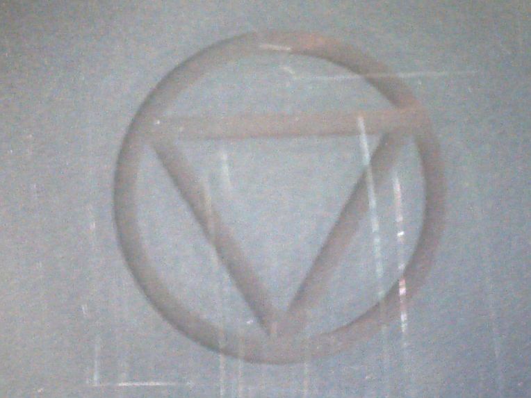

The Stop/Resume field is located maybe an inch to the right of the colour copy sensor field. It might be seen when letting light fall on it at a shallow angle. Here is a photo from an MG7150 that also has got sensor fields, click to enlarge.

The service manual also mentions a Stop button instead of a stop sensor field. See page 45/66 about entering service mode.
