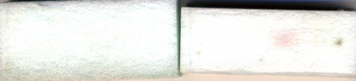

Another thing I noticed between the two sponge materials used in the carts is the top sponge is made of a much less dense (Course) material, where as the bottom one is more compact and smoother to the touch. (Finger test).
This is the ---------------------- Top sponge ----------------------------------------Bottom sponge
Thank you for comparison, this seems to correspond with the different functionality of lower and upper sponge
7,181
The behavior of the top sponge would be expected to be different if the top sponge was still clean. After it gets saturated, does it accept or reject ink on subsequent refills?
I thought the top sponge takes on ink but after minkling's photos I am not sure. Now that we've been discussing this, the next time I refill I will pay more attention.

i'm sorry i just can't read 14 pages of this posting again, but if this is about drying the cartridges, after flushing with solution i take a wet/dry vac to the exit port and you can see the liquid come out of the cartridge, that way you can dry it as much as you want very quickly, also it seems that once the upper sponge is flushed with the solution it now attracts ink, when it was filled as a "virgin" cartridge (unflushed) the ink never seemed to migrate to the upper sponge. just my observation
