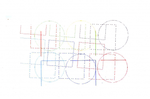

. I would like to see how it behaves at 100%
Scan of your 1200.png, print done at same size 100% with resolution 1199 PPI…
This was the result....
Then scaled to 337% and printed with resolution 355PPI…
Untitled-2.jpg click to enlarge...

Thank you! What is the printer model?
What does this all mean? What is it you are demonstrating?
I understand but am asking for a friend. ;)

I'm still completely lost why you would try to print with 1200 or 2400 dpi and rescale your image before print - Canon printers don't do 2400 dpi image pixel resolution, and Epson printers don't 720 or 1440dpi, or are you
testing software - different interpolation schemes and not hardware resolution ?

With all of the great work that you’ve done with your art work, and yet you still don’t quite understand how an inkjet printer works, the resolution of the printer doesn’t matter as I demonstrated with your own 1200.PNG files.
No printer is going to print any better than your current Epson printer will, because it’s the quality and size of your image that determines the final outcome, not the printer.
A one metre image will print with huge PPI if the image prints on paper at 10cm. and a 10cm image when set to printout on 100cm paper will have very low PPI, (Pixelated) and the image will be un-recognisable.
As I showed, your 1200.png file when printed at same size gave 1199 PPI and the same file when scaled to 337% has a 355 PPI, so I did one more for you and achieved your .1445 PPI, but the image was only 83%.
