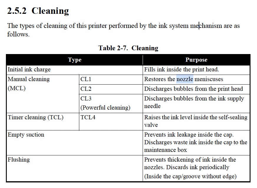

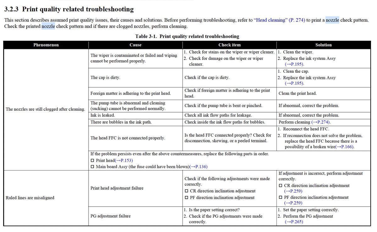

I think your issues are beyond my pay grade. If you want more ideas on ink clog issues, you can look at the P900 maintenance manual which can be accesed here through Scribd (90 day free subscription). Quite detailed with color diagrams etc: P700/P900 Maintenance Manul
Here are two screenshots one of the cleaning cycles in the P900 and troubleshooting guide when you do not have a clean nozzle check:
I provide these as a pointer and also so you know the issues can be more than just clogged nozzles.

3.2.3 I will look into the wiper, eventually dirty cap and forign matter adhering to the print head. I will use windex and polyalcohol and lot of patience while performing under printhead cleaning. (if possible modus Entlich) ??
