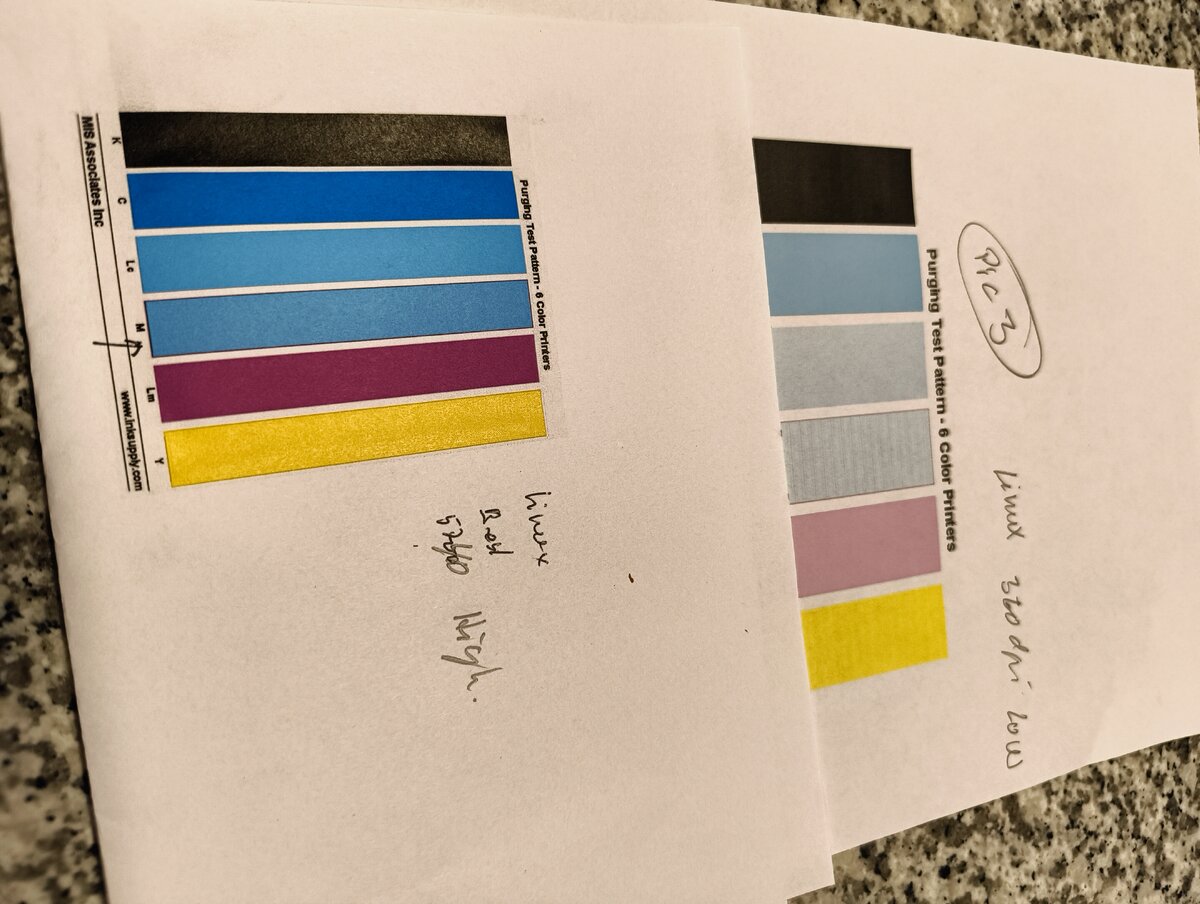

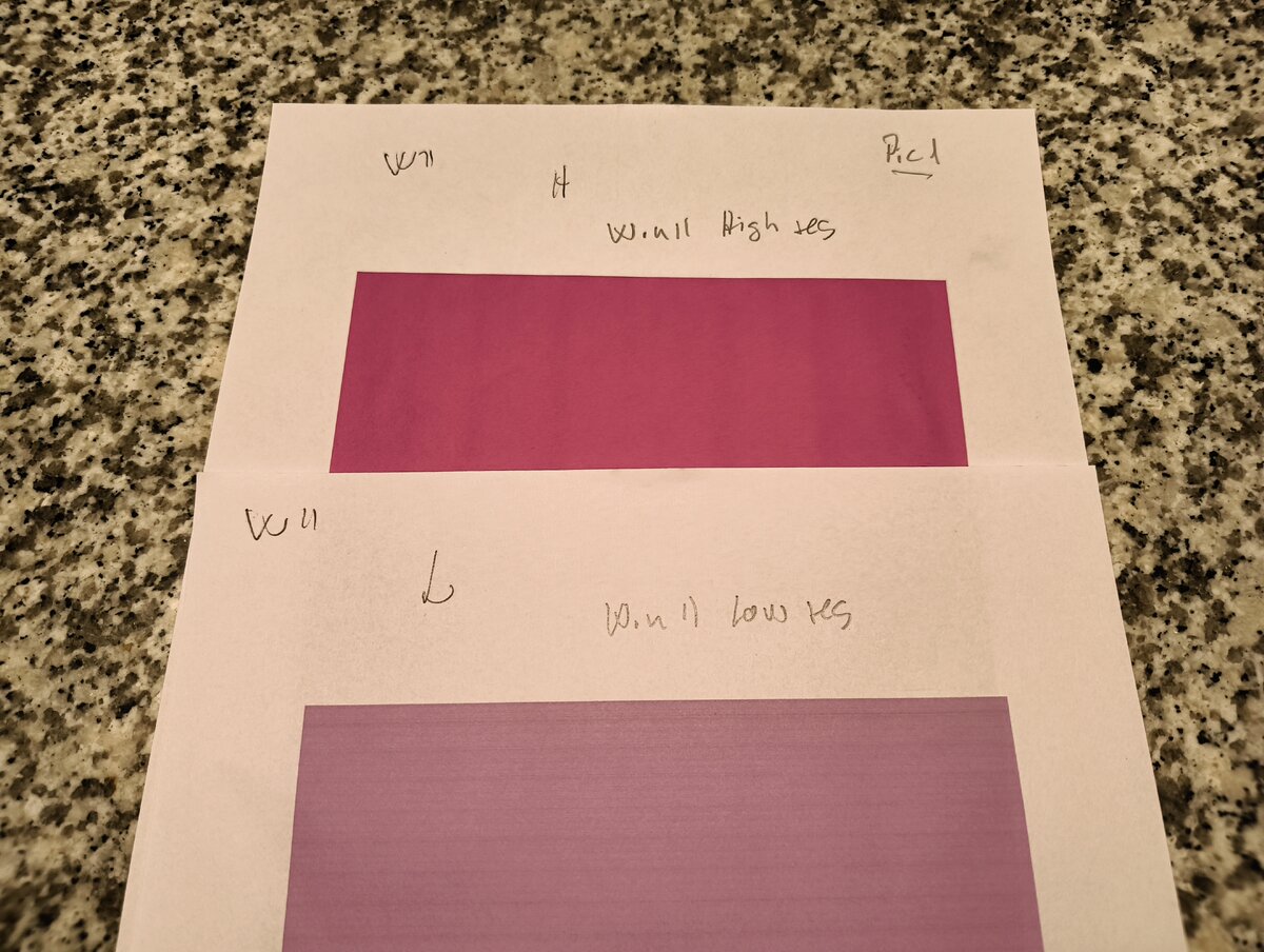

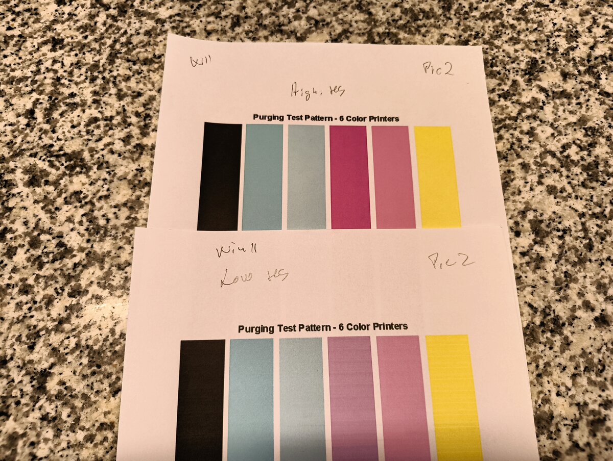

  • Windows 11 (see pictures 1 and 2):
    • High resolution → prints well, correct magenta.
    • Low resolution → bad output, cyanish tint instead of pure magenta.
    • Epson Print Layout → prints as with win11 driver
  • Linux Mint with Gutenprint (see picture 3):
    • Magenta prints as cyan.
    • At higher resolutions, more cyan appears, with a faint magenta “halo” around it.

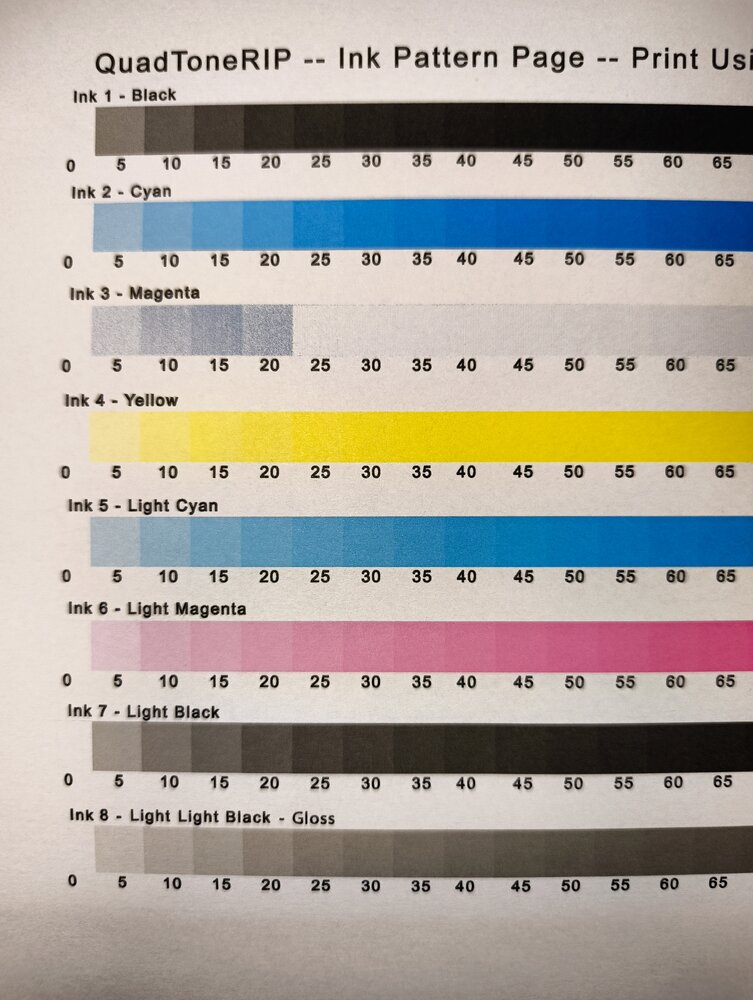

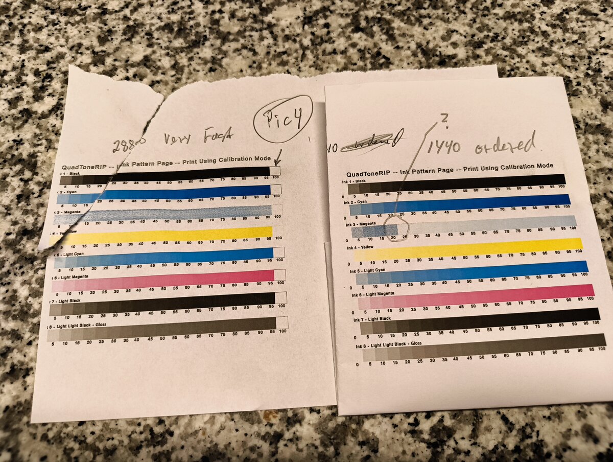

  • QTR (see picture 4):
    • Magenta is still cyan.
    • At 5700 dpi, 100% = 0 (strange behavior).

Hi Carsten, I too have an Epson P900, and the color of the tubes is the same in mine, and mine is working.
The problem lies in the regular magenta channel, whose issue remains unresolved.
I would not spend any time on the six color test patterns. Those patterns do their best to reproduce the intended colors, yet my understanding is that since the Epson P900 is a ten-ink system, it will mix different inks to achieve those six patterns. The amount used of each is unspecified, yet these do not represent individual color / ink channels. It's sending you on a wild goose chase.

I agree (partly) with you on the 6 color test. But wonder about the difference between low and high resolution. And what happens when i go Linux and Gutenprint.
I have used QTR to flush channels in the past. Its the best option. The second best is individual purge file.

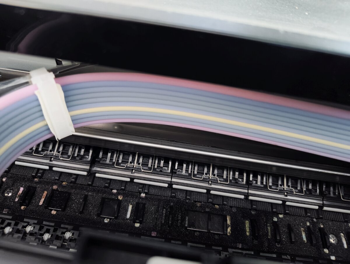

Looking at your nozzle check you definitely have a hardware problem. Yellow has some issues, no vivid magenta coming through, and instead some cyan leaks through the vivid magenta channel.
The nozzle check is pretty 'raw', done by the firmware. So before investigating software, the nozzle check should be near perfect. This check is also revealing why you are getting different results across different settings/operating systems: some are composing the 6 color print with the VM channel while others are not.
My recommendation is to first identify why the VM channel is leaking cyan. Then investigate the missing VM throughput (probably related). Finally address the yellow channel.

Is it still patience and TLC. Cleaning with a lint free cotton as described by Arthur Entlich? I have his manual.
Still I am very confused with the QTR. The Magenta channel, spewing Cyan, suddenly increases at 20%. I wonder if that was the initial problem that caused Epson to replace the printer with another printer to former owner. As I remenber there were cyan streaks in her B&W pictures.
Rigt now I am depleting the Magenta and the yellow by printing solely magenta/yellow with QTR. It seems to deplete the Cyan.
If nothing works I have at great B&W printer working on several channels.

It is pointless and wasteful to continue diagnosing with software printing long as your FIRMWARE printing has obvious problems. The prints you get from QTR are meaningless for diagnostic. It is like you are trying to diagnose an car engine problem by looking at how the wheels are spinning, while ignoring the report a technician just gave you (the nozzle check)! You need to either get in there and solve the hardware problem or find someone experienced that can do that for you. Printing anything until the nozzle check is OK is pointless.

I agree with @x64. You are seeing software issues with Quad Tone RIP and it is distracting you.
To help you understand, here are the Windows reelease notes for QuadToneRIO version 2.8.2 (most recent I believe).
Note that it mentions not supporting all ten inks of the P900, simulating black, and that the VM is not supported. I think that is a pretty good indication that you cannot depend on QuadToneRIP to do what you think it is doing:
QuadToneRIP version 2.8.2 and 2.8.2 Release Notes
This is a bug fix for version 2.8.1 or 2.8.1.1 -- all users with either should upgrade.
The release also includes new versions of Print-Tool and Data-Tool
!! --- Windows Caveat --- PC users must read !!
The PC front end QTRgui unfortunately cannot support 10 inks. So due to the
importance of MK ink I've decided to simulate the switching of blank inks as has
been done for many previous Epson printers. The violet ink is not supported with this.
To accomplish this I've created to additional printers named P708 and P908 that
are usable as 8 ink printers. They will use the Black Ink selection in printing to
give you matte of photo ink. So inks are: K, C, M, Y, LC, LM, LK, LLK
Note that K represents either Photo or Matte black ink depending on the printing dialog,
just like it's always been before.
Important:
This has several side effects that one needs to be aware of. The .quad and .qidf files
are mostly the same but incompatible for using matte black ink.
This is the general idea:
Use QuadP700 and QuadP900 if you have 10 ink curves made somewhere else i.e. on a Mac,
Piezo, Boutwell. You can't use QTRgui on these.
Use QuadP708 and QuadP908 if you want to Create curves/profiles yourself using QTRgui.
It's all similar to what you might have done with previous printers
NOTE!: So I would not even count on it flushing the correct inks either
