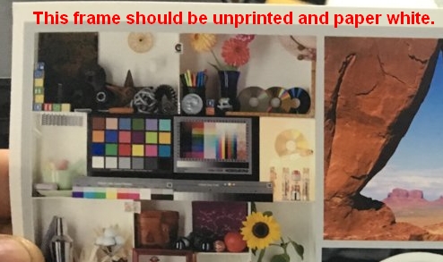

The print in post #21 has passed through several links before I see it. First it is photographed, how does the camera change the image? Then it is uploaded to the printerknowledge server to be displayed on the forum. Does the server compress it to save memory? It is then opened in Firefox on my Win 8.1 computer. Does my hard- and software change it? It is then displayed on my HP monitor that is a good monitor for home use, but is uncalibrated and not professional grade. My ambient lighting and colour of the wallpaper also plays a role. Finally my personal preferences also plays a role in what I think about the quality of a print.
Here is a crop of your uploaded picture. The test image should have an unprinted frame that should be paper white. The frame appears yellowish grey in your uploaded picture. I don't know how to remove this yellowish grey, but if I compare it to a layer of varnish and imagine it removed, I think the colours will be more clear and the print a good quality. Here is the instruction for how to judge the test print. And as a traditional link here, in case your browser doesn't like a word-link: https://web.archive.org/web/2015031...ckphoto.com/printinginsights/pi049/essay.html

I taught the print looked a little bit flat and yellowish, I reckon that’s down to the paper and or your picture taking.;)

thanks, no idea of how to remove that gray when it supposed to be white i will take again a picture with the dyaligth sun and see it.

Some cameras have a white balance setting in which you can point the camera to a white area and define that as white. Could you calibrate the camera by using an unprinted sheet of paper?
I think some photo editing program s might have the same capability. You can click a point in the image and define that as white. IIRC even some free-ware programs can do this.
