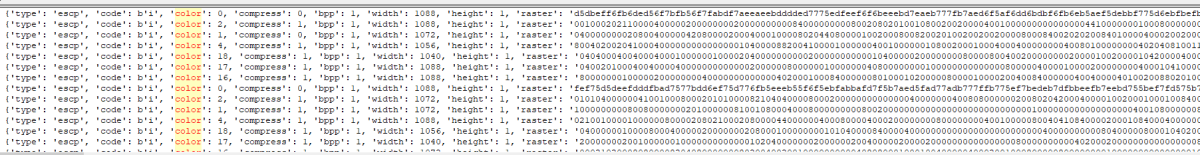

I also check the Stylus Pro 4000 glossy paper behavior, it seems like not only full PG black channel. Other 6 ink channels
also print something when it's black.

Quick update:
It's spot read 2.2 on RC paper compared with original cast coated paper only 1.4
It's the L365 driver print to XP-2101 printer on Premium Photo Glossy Quality, I also check the Matte High.
The paper still the 130gsm Inkjet cast coated paper.
I would try on my RC glossy paper later.
I also check the Stylus Pro 4000 glossy paper behavior, it seems like not only full PG black channel. Other 6 ink channelsView attachment 14237 also print something when it's black.
