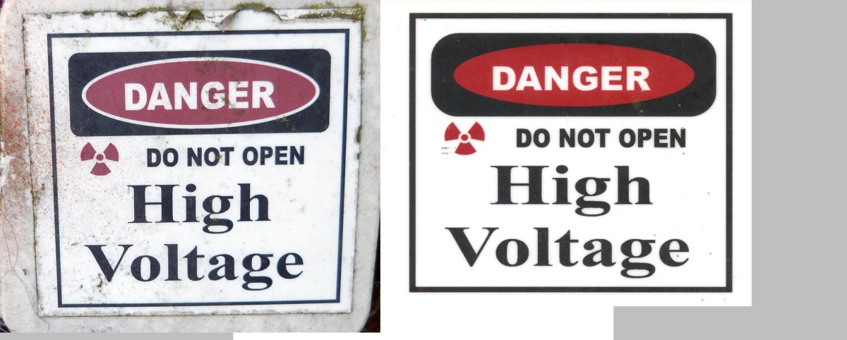

Would it be true to say Pigments inks will essentially be waterproof on printable vinyl?
Yes pigment ink is water proof on Vinyl..
Here is a Vinyl sticker I did quite some time ago, (several years) and here is the results, the one on the left is the one that’s in place outside and the other is one that has been kept indoors.. (laminated)
Which EcoTank has the fastest speed for colour printing?
But I wouldn’t put pigment inks into an Eco Tank, unless you want trouble, yes they will work for a while, but after that who knows..
Printed on a Canon Pro 9500 with I.S. pigment inks..

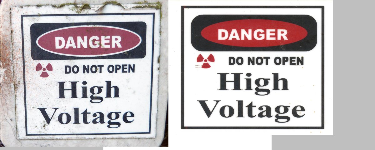

The big question is what level of Water-Resistance or Water-proof do Pigment Inks offer when the print is NOT laminated? Should the pigment inks withstand being put under a water tap for one minute?
