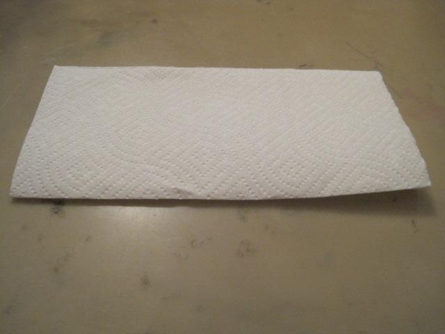

It's very easy to drain all the ink out of a Canon cartridge.

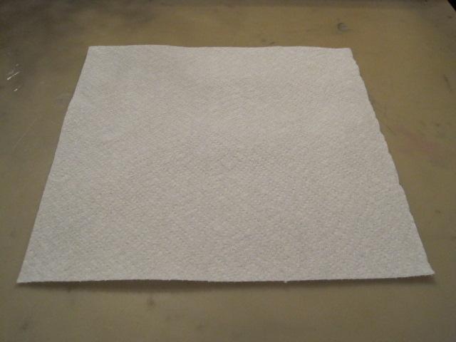

Start with a sheet of paper towel (kitchen paper, I believe it is called in the UK):

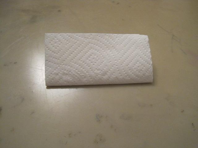

Fold it in half:

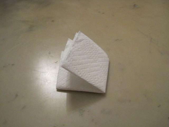

Fold it in half the other way:

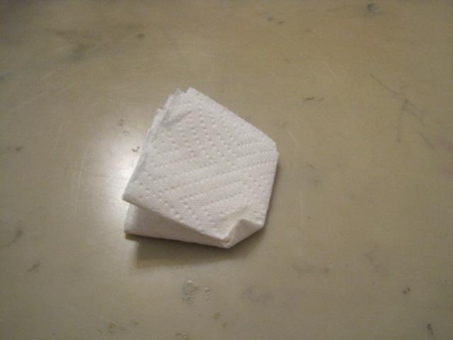

Fold it in half again:

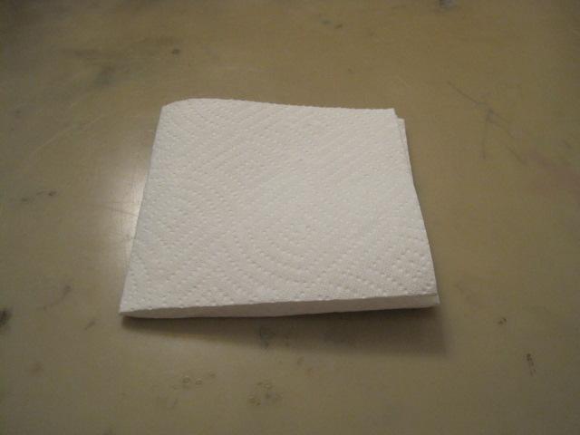

And once more the other way:
Now it has sixteen layers of thickness. Fold over the corner of the last fold:

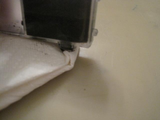

Apply this corner to the inside of the outlet port:
Wrap the two diagonal sides of the paper towel along the sides of the cartridge and secure with a rubber band:
Place it on a surface that can tolerate ink and let it sit for a few hours or overnight. The paper towel will become saturated with ink. You may have to repeat the process to get all the ink out.
