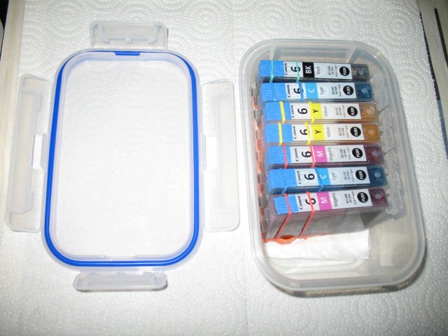

The orange stoppers come originally welded to the cartridge and can withstand air pressure fluctuations. But when you break them off and then try to hold them on with a rubber band and seal the vent with tape, air pressure fluctuations will force air in and out the outlet port. It could either result in ink being forced out or air being forced in and drying out the foam. Leaking is especially a problem if you ship the cartridges. See this link:
http://www.nifty-stuff.com/forum/viewtopic.php?pid=12328#p12328
It's OK to use the orange clips held on with rubber bands, just don't tape up the vent hole.

I should add one other thing: put your stoppered cartridges in an air tight plastic bag like a ziplock bag. This won't prevent daily air pressure fluctuations from forcing air in and out of the cartridge but it will maintain a relatively constant humidity on the inside of the bag and reduce drying out on the inside of the cartridge.
With shipping involved, all bets are off as now the carts are possibly being subjected to aircraft pressurization and de-pressurization.
For home use re-stoppering and taping has been 100% trouble-free here. I also have found that the Snap-Ware line of sealable containers are perfect in size for storing BCI-6 / CLI-8 type carts. Keeping the carts in an air-tight container probably enhances the other two measures.
