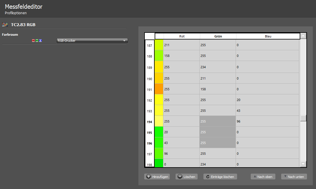

I have a patch sheet editor as part of my i1Profiler program package which allows me to modify a patchsheet - you can add or remove color patches or relocate them, you just enter patch colors by the RGB value.
Yes, but to enter manually is crazy, or to enter with automation software.
I have been playing with this editor. I took me alot of time to introduce the extra desired amount of neutral and near neutral patches into an existing generated 581 patch target to increase it to 700 patches. It is based on the RxGxB patches of 8x8x8 and grey ramp/(near) neutral patches/white/black up to 700.
