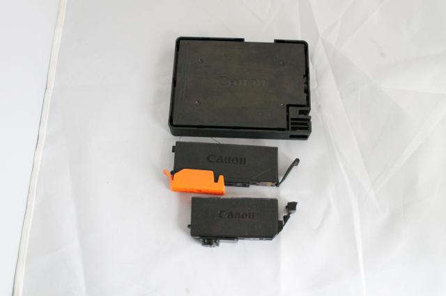

There is a difference in size, I have a picture, but do not know how to upload it on this page

The top cartridge is the Canon 29, the middle one is CLI-551 and the bottom one is the CLI-526
5,151
5,045
Thank you for the picture. You clearly see the difference in size between these cartridges.

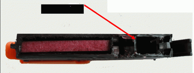

Well, I have refilled these cartridges without any problem. Refilling method is the same as for all the other Canon cartridges (i.e. PGI-525/CLI-526 - PGI-520/CLI-521). I used the same (IS)ink as I used for those cartridges and there is no colour difference. The ink monitor can be disabled in two ways:
- by holding the resumebutton for 30 seconds or
- disable the monitor in the menu printersettings
I have made Dutch refillinstructions.

http://www.refillink.nl/PDFDocs/PGI_550.PDF
I know there is a way of filling by drilling holes in the side. But here you have to be careful because the normal cartridge is partitioned in compartments in the inkreservoir (not the spunge) where the XL version is not. See the picture

I read carefully the way you refill your cartridges, it may well work for you but its a little bit to light on safety.
You have no way of knowing how much ink you have put into your cartridge or how much leaks out during your refilling
and I could see problems arising out of using this method sooner rather than later.
I would strongly recommend you view this method and then maybe
you could amend some of the ways you refill yours a bit more.
