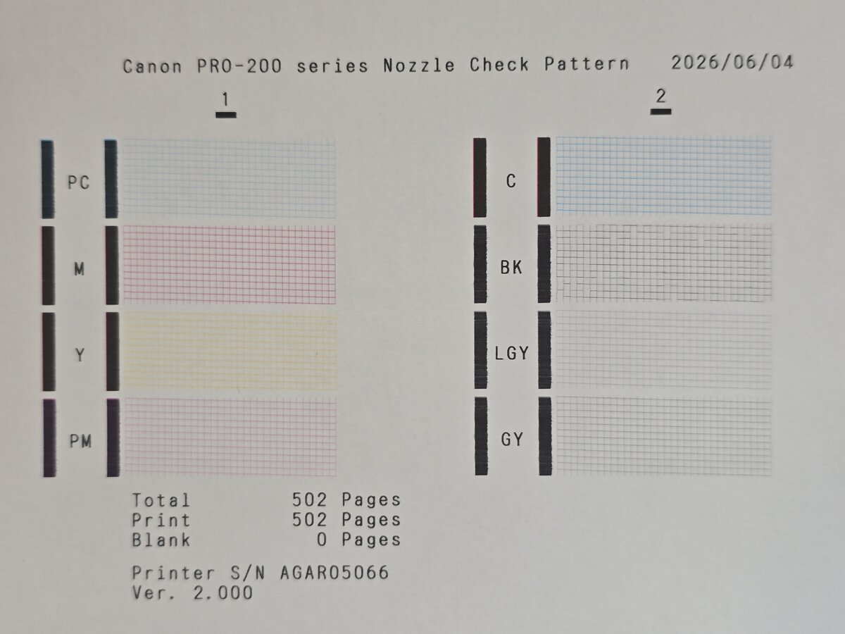

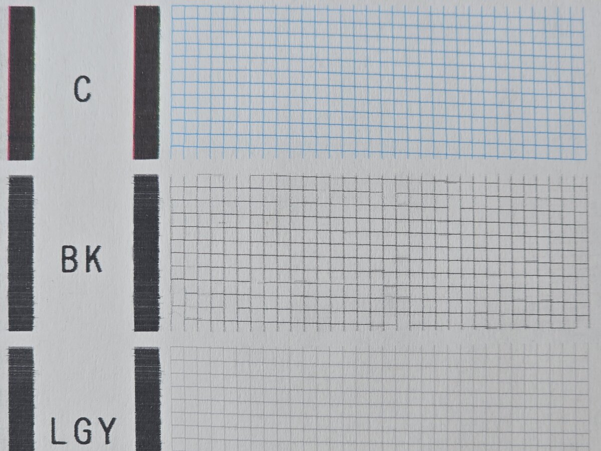

Hi all. I have a Canon PIXMA Pro 200 that I picked up second hand from Marketplace (so there's no returning it for a refund) and I'm having issues with the black ink only, all other colours are printing fine. On the nozzle check the black is missing lines in the same place in every print, see image attached.
The printer came with ink from cartridgepeople.com (seems to be genuine used cartridges with 3rd party ink I think).

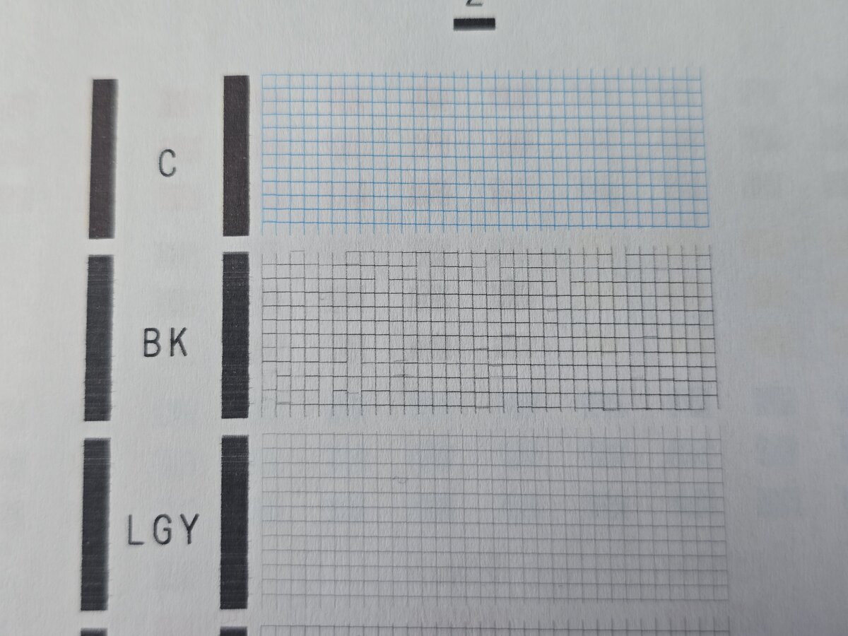

I've tried standard cleans, one deep clean, reseating the cartridges and print head, leaving it on overnight, leaving it off while at work during the day, and nothing has made a difference (reseating the print head MAYBE made a tiny tiny difference, but it could have been a fluke).
The nozzle check patterns are always identical, except there's one or two places where it sometimes manages a line where it doesn't other times.
Printer had printed less than 500 sheets when I got it (it's now just over from printing nozzle checks.

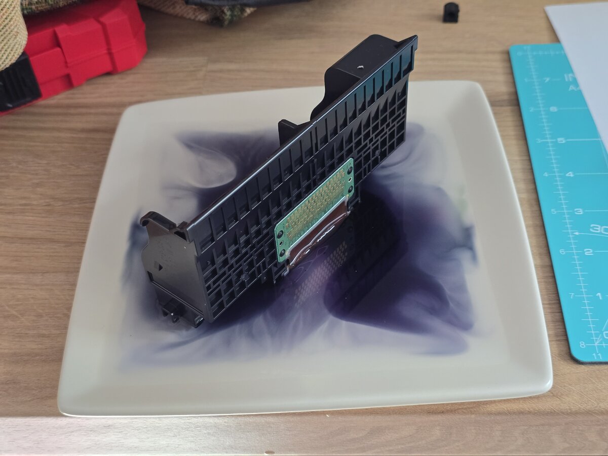

I have ended up trying a slimmed down version of this however since I've given up all hope of reviving the head any other way. I put the head in 40 degree C deionised water for just over 5 minutes. Lots of black ink poured out upon touching the water which makes me think a seal inside the head might have gone. If that's the case then I'm actually happy because it means the issue is with the head and not something upstream, so I can confidently buy a replacement head without worrying about it being a waste of money because the issue is elsewhere.
I'll report back later once it's had plenty of time to dry on whether it made any difference, but I'm not hopeful.

If the blank lines always occur in the exact same location then you probably have clogged or broken nozzles in your print head. First I would perform a print head soak and use only genuine Canon ink. If performing the soak and using Canon ink has no effect on the nozzle check pattern then you print head is probably broken and you'll have to replace it.
