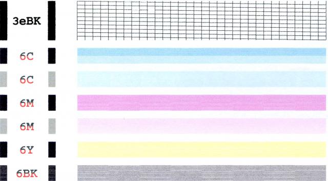

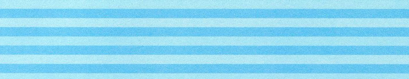

My problem is my printer is printing 3mm wide horizontal bands or stripes.
This light and dark banding only occurs with the color cian.
Magenta, yellow and the blacks are perfect.
I have: Replaced the cian cartridge.
Run numerous nozzle cleaning and deep cleaning actions.
Aligned the printer head both automatically and manually.
Removed the printer head and cleaned all electrical contacts and nozzles.
Uninstalled then reinstalled the printer driver.
None of these actions have resolved the cian banding.
Please can anybody help me with this problem.

First of all dont be running any test prints while your cyan is not printing properly.
Can you print out a nozzle check and post it on here first, so we can see what is going on with your printer.
Then wed have a better understanding of your problem and hopefully be able to help you fix it..

newrotic
Nov 5, 2010
I hope I've uploaded these pics OK.

That cyan problem is an electrical problem not a clog. You can either get a new print head or a new printer. I don't suggest getting the ip4700, it's designed to waste ink if you decide to refill it without resetting the chip. I've abandoned Canon now because they're making it too difficult for refilling, either wasting all your ink or for the latest models, opaque ink tanks.

That sure looks like an electrical defect in the print head. You may want to buy a new print head as your ip5000 is a very good one. It is better than any new ones released by Canon in recent years.

How can I be sure it's the print head?
They're not cheap.
