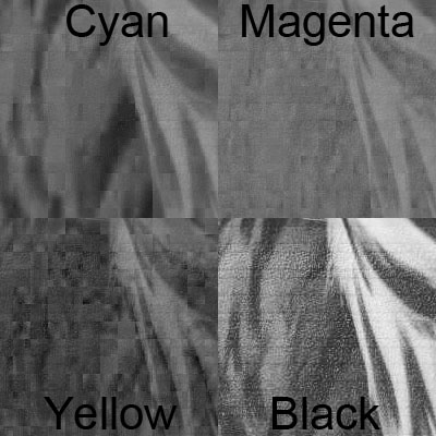

This looks like a classic case of banding at the bottom. Try the trick posted by Pharmacist it doesnt fix the problem, it just masks it like the rest of the print. There is a short explanation in this post.
Here is a 200x200 pixel crop from near the bottom of your scan, converted to C/M/Y/K and split into its C/M/Y/K channels.
There are obviously a LOT of jpeg compression artifacts (the boxes that appear on the C/M/Y channels) that are caused by the jpeg compression of the image from your scanner - these are not bands from the printer. The banding appears to be mainly in the black channel, and it looks like you have a partially clogged print head. Did you do a nozzle check? Does it show missing nozzles? BTW - similar tests on the rest of the image didn't show banding (as your eyes have already told you).
