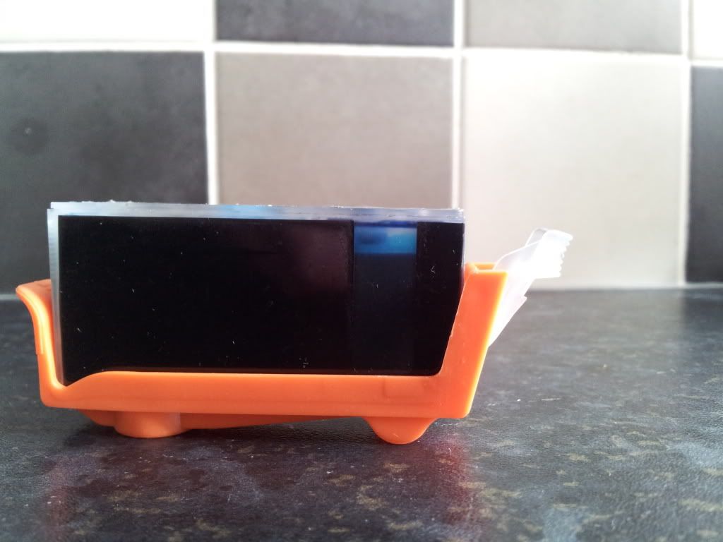

Had a go at my first refill today and all went smooth with very little mess :) just would like to know if my fill level is ok and would my printers ink moniter tell me its low before the cartridge actually runs ous..
Also i wont be using the refilled carts for a few days , are they ok to store for a while with exit port and air maze covered up for a while?
16,113
9,068
Your cartridge looks to me to have been filled by an expert, well done.:thumbsup
There's more than enough ink in the cartridge for your printer to work correctly, no worries.
The cartridges will be safe to store in that condition for month..
