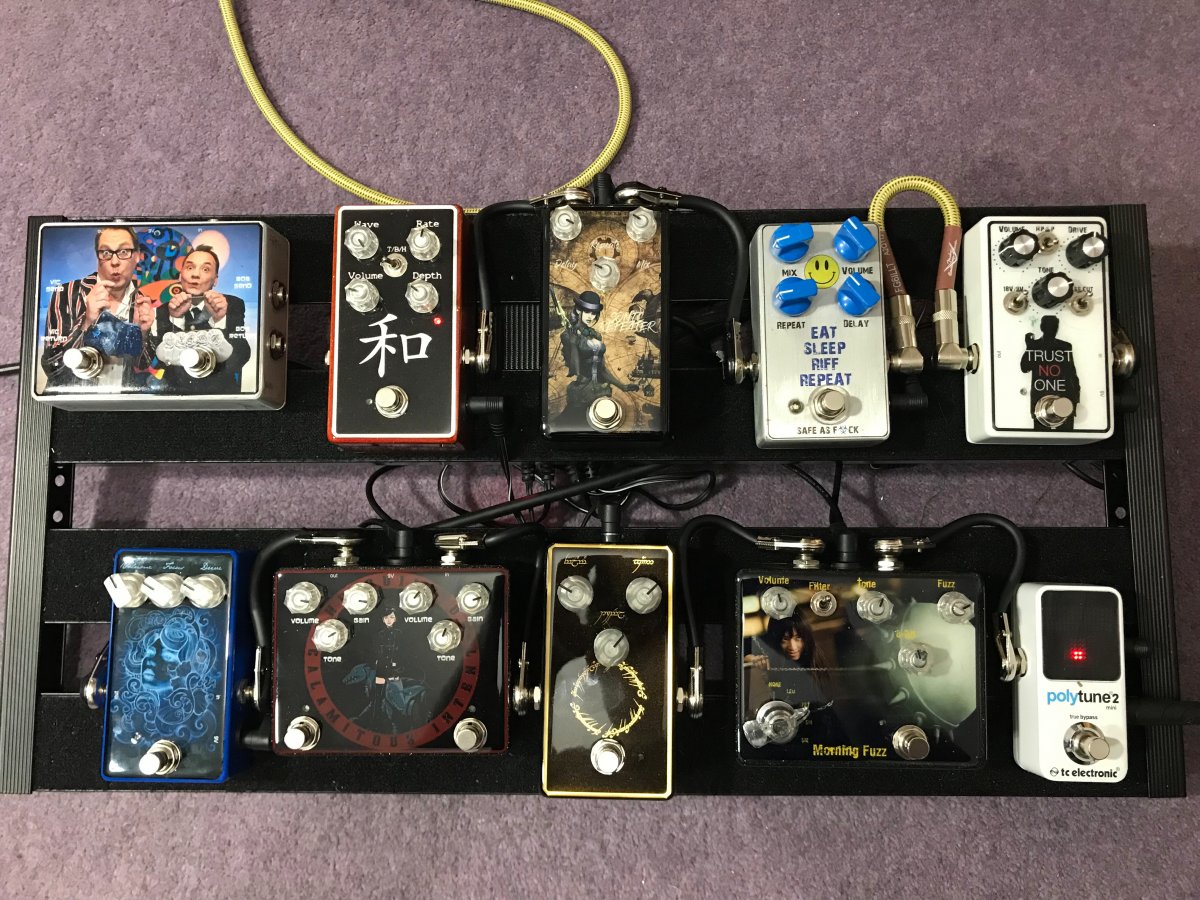

Thanks for the diagnosis gents. I had assumed it was a goner but thought I'd check just in case it could be saved. The print quality was perfect for my use case. I've probably killed the black nozzles by printing excessive black ink onto gold and silver self adhesive paper using third part inks. I build a lot of pedals in this style.
One final question could anyone recommend a printer for this kind of application?
@stratman I've attached a sample to this post so you can see the kind of builds I like to do
7,176
Super creative work, Golden. :woot
You must have one helluva pedal board!
You said you use aftermarket inks. No third party dye-based inks are known for their archival fade resistant properties compared to OEM Canon ink. Not even close. Have you noticed fading of your prints?
On the other hand, aftermarket pigment inks are generally thought to be significantly fade resistant compared to dye-based inks. Also, pigment inks are water resistant. Not a bad thing if playing in bars with sloppy drunks, whether patrons or band mates. :gig
However, the paper you use also determines fade resistance characteristics. Also, your paper may be specific for dye-based inks and not pigment inks, so proper pairing of paper with ink is needed.
I mention this if you are considering a new printer rather than a new print head.

Thanks @stratman I'm pretty sure I'll go for a new printer. I've had a look and a new print head is going to be approx £100 for an official canon one and a lot less if I go to aliexpress but I'd be highly dubious of those tbh.
I'm going to put the ip7250 into the house and use it to print documents whenever the need arises as that cartridge is working just fine. I'll order myself a new photo printer whenever I can find one in stock anywhere. I had a look last night and there's some seriously slim pickings out there at the minute.
I've genuinely never noticed any fading to any of my pedals. I've sold a lot and given a bunch away and no one has ever said anything about it. I'm not too bothered about water resistant properties in inks either because I coat the tops of all my builds in epoxy resin. Regardless of abuse from feet, spillages or anything else they pretty much all look brand new and it really makes the colours pop.
My board changes ALL of the time I took this one a while ago it never really stays the same for more than a week or so. Too much choice ;)

Awesome board. :thumbsup
I don't know what most of the pedals are but they look great, including the magic box top left that needs no cable. ;)
For me, it was lust at first listen to a Maestro PS-1A Phase Shifter my neighbor was rocking on Starship Trooper by Yes in the 1970's. PFM! (Pure Feckin Magic)
