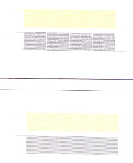

5,140
5,024
Hi IanYY
I think it's a printhead problem, and that some printhead cleaning might fix the problem.
I have just experienced the same on a smaller scale with a Pixma 3600. Here is a picture showing part of extended nozzle checks from service mode before and after ordinary printhead cleaning from the maintenance tab. See top right corner of the photoblack pattern. Note also how much better high resolution paper is compared to ordinary copy paper for printing extended nozzle checks. The top is before cleaning, printed on ordinary copy paper, the bottom is after cleaning, printed on high resolution paper, click to enlarge:
