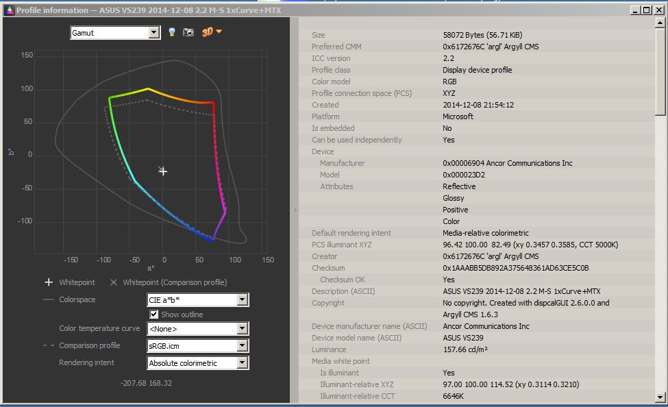

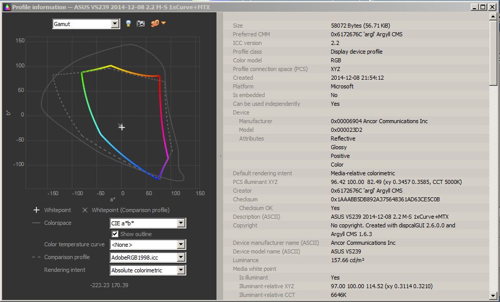

I really haven't a clue about the detail of ArgyllCMS dispcalGUI as yet, but here are two of the outputs available from dispcalGUI as a result of the profiling of an ASUS v239V. The first versus sRGB and the second versus Adobe RGB1998.

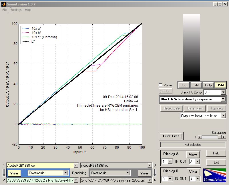

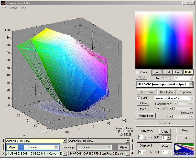

The third and fourth are Gamutvision B&W Density and 3D L*a*b* versus Adobe RGB 1998

Look good to me Emu.
Despite my loud mouth I am by no means an expert, just know enough to trouble shoot any simple problems I run into. :rolleyes:
One comment about your charts/graphs - I note you are running at a fairly high luminance level at 157 which is pretty high.
From this I would surmise you are viewing in a very bright room. If the ambient light level drops does you monitor appear hot or very bright? Guess all is well if it works for you. I would imagine something as sophisticated as ArgyllCMS dispcalGUI would monitor luminance in real time, given that entry level spyder and X-rite do this.
How do your prints look? One outcome of a high luminance level could be dark prints or "crushed blacks" in the darker tonal ranges.
I was also mildly interested to see that your charts described their rendering intents as Absolute colorimetric, and the table gives the rendering intent as Relative colorimetric. Probably nothing of consequence.
All these comments and posts are valuable learning tools as we increase our knowledge base.

Nice to see someone has looked carefully at the content, I am not wasting my time! Yes Roy I noticed the 157 and as I normally run at 110, I reacted as you did. This is why I said I hadn't a clue about dispcalGUI as yet. Further examination of all the data shows that luminosity is set to 120, which it had assumed, without asking me. I speculate that 157 may be the maximum capability of the display, but I am not sure! It certainly looks like 120 in practice.
I hadn't noticed the Absolute Colorimetric, so that is a new question to be answered. Does it use that to show the maximum extent of the gamut? It looks as though I would be able to switch it, to look at the others.
There is a lot to read about ArgyllCMS DispcalGUI and a lot of it is not designed as easy reading for the uninitiated.
One thing the exercise has shown is that the latest £200-£300 monitors can produce reasonable results if you are looking at sRGB. AdobeRGB is another matter, but when you look at the printers' performance, they still leave something to be desired.
