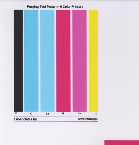

I tried onr more cleaning cycle on the new ink cart and got much better results. The yellow came back but there were streaks in other bars, and the magenta was much deeper is color. I decided that I had to clean the bottom of the printhead one more time because of the streaks in several colors. This time I use hot water, but by the time I got it to the printer and put it on the paper towel under the printhead it was just warm. Anyway I cleanded it back and forth and got a lot of all kinds of colors, mostly black. ONe more print of all color bars and 99% of the streaks were gone. Printed a high quality photo on my best paper and got excellent results. Now that I go back and think about this printer, which has not had that much use, buy I have always printed something at least once a week. The real problem is that because of my lack of experience with Epson printers, I was no aware of how much ink accumulates on the bottom of the printhead. There is no wiping station in this printer and for 1+ years I have not cleaned the bottom. I was not aware that I need to do that. From now on I will clean the bottom before I start to print any serious photos. Three months ago I printer 15 medium quality posters for our golf club tournament, each with large print and special photos. These were 13 x 22" prints and used a lot of ink. I never cleaned the printer after that. This is all dew to the lack of knowledge of how to take care of an Epson. It has worked so well for me for 1+ years I ddn't know how clogged the bottom of the head was getting.
If anyone knows anything about a wiping action in this printer please let me know. It seems to be a design flaw if this printer does not have one.
Here is my final 6 color bar test.
So as I go back and remember all of the problems I was having, they were probably due to clogged head either on the inside or the outside. All the extra cleaning just left more ink on top of more ink. So when I did the initial cleaning with the paper towel, and changed the ink cart, things changed but did not resolve the clogs. When I really did the cleaning several times with hot water ( I actually used warm windex), the head cleaned up and one more heavy test print of the single large bar of magenta finished the job.

If you had solid blockage the bars would not come and go. It would have been blocked and not printed anything until cleared....and they were clear before your last bout of missing ....as you had printed a perfect picture prior to that.
Next question, so you're printing and then you get banding....so how the heck did that happen in microseconds if the nozzle is still in contact with liquid? , to suddenly get a blocked nozzle ? Unless the ink had huge impurities within it and there are filters prior to the chambers?.
Look at the link to the article I posted. You will see the contruction of the head and then be able to understand what is going on. the piezo pump is not a 100% displacement pump. It works by little squeezes into a large volume, that is why once you get compressible air, the squeeze can't push out the ink, the bubble simply compresses inside the chamber.
There is a type of wiper on the 1280. There has to be. It is not fashioned like the Canon's. Do realize that each time you turn the printer off and then on there is small purge that occurs. This small purge is enough to clear the microbubbles as it did for the originator of the thread on the following day.

Mike,... and anyone else that may have this problem, no need to get upset about this. I know you have put in a lot of time on this one thread. However, others are going to learn from these results. I guess you pointed out a key problem we all have with one little word,... "Clog". It can mean a dozen things to 6 different people. I, and many other people, use the word very loosely. When I say I think the problem was a clog, I mean a clog of some kind. It could be an air clog, a dried ink clog, or just so much wet ink on the printhead that the results look like a clog. I don't think there was any kind of blockage, or clog, or bubble, or anything inside the new ink cart I put in. All I did to make the printer work was to install a folded up paper towel under the printhead for 10" long. Then I wetted the first 4" and moved the head over and left it there for 30 seconds. Then I added more (Warm Windex) to the towel and moved the head again. I repeated this over and over. When that towel was totally black and soaked with ink, I pulled it out and replaced it with another one and started all over again. For the final pass, I moved the head to the center once all the towel was wet and then I picked up both ends of the towel and used it like a shoe shine rag, pulling it to both sides of the head, over and over. I thing I really got most all of the residue ink off of the face of the nozzles. This was clearly blocking some of the ink so it never got out of the head.
Then I printed a 4x6 image of the 6 color bars and noticed a considerable amount of banding, or white stripes in the magenta bars. The other bars were in good conditioin, even the yellow which had been totally missing. So then I did one head cleaning cycle, and printed a large 4x6 image of just magenta to purge anything that may be blocking the nozzles. After that I re-printed the 6 color bars and all of them were perfect. I then printed a 8x10 photo on premimum glossy photo paper and it is good enough for mounting in my upcoming art show.
I don't care what we call the problem,.. whether it was air bubbles in the head, clogged nozzles, dried ink or wet ink on the face of the head, or whatever. It was fixed by several paper towel head cleanings and one regulary head cleaning cycle and one purge print.
If there is a wiping station in this printer, it is doing a terrible job. I've pulled many heads out of very old canon printers, and at the most I can wipe all of the residue ink off the bottom of the head with one slightly wet paper towel. If you were to see the amount of ink I got off the bottom of the Epson printhead, I think would agree that I was lucky to get anything to print through that mess. I will check some of the Epson Service Manuals I have and see if similar printers have a wiping action like the wiper blade in the Canon purge unit.
I hope this thread helps someone else. It sure has made my day,... I got my top quality printer back.
