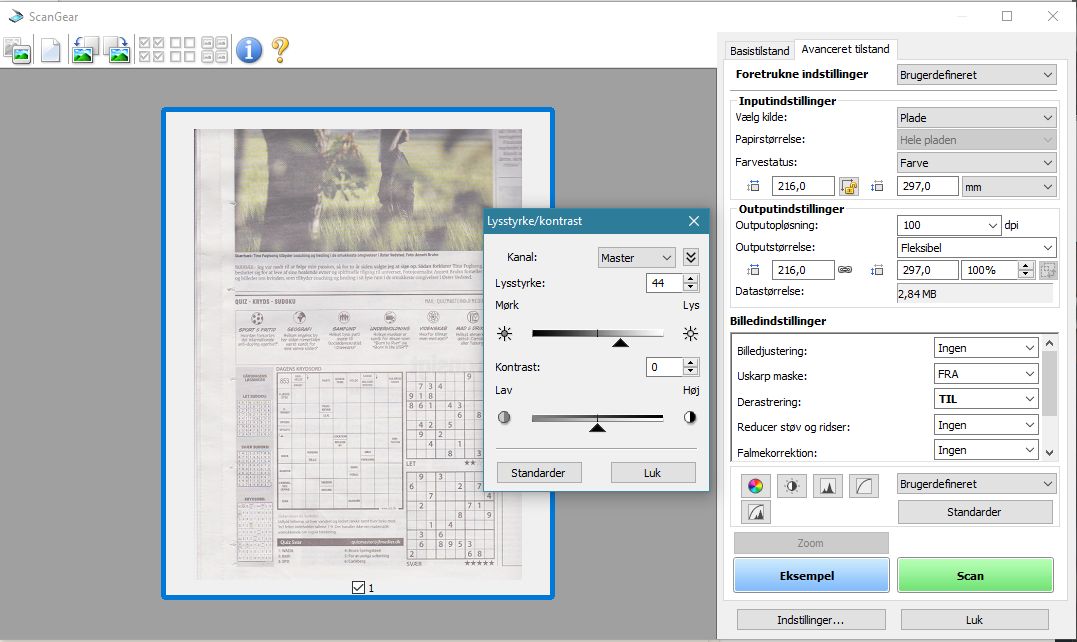

The Canon scanner program for Windows "Scangear" has got two tabs with setings, one basic and one advanced, see this, click to enlarge:
I don't know the Canon scanner programs for Linux and MacOS, but I guess they are much more basic and might not have the advanced settings.

Oh. In that case I'm a little confused. I thought that the point of that was to do a nozzle check, not run the scanner. In any case, Canon isn't offering Scangear for my printer. They just offer this MP Navigator. I tried downloading Scangear from https://canoncanada.custhelp.com/ap.../[windows-64bit]-color-network-scangear-v2.71 but it seems to insist that the printer be networked.

If the scan or a photo of the nozzle check is not high quality then it is of no use to diagnose the printer.
