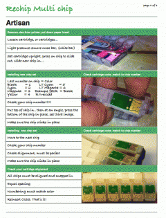

Hi cbsamc
The 837 requires the newest chip set...
Contact us directly at LJHent.com and we will send out a replacement chip set at no charge..
http://ljhent.com/contact/contact.php
The re-chip process takes just a few minuets and you will be back and printing shortly...

I finally got the Artisan 730 (with updated firmware) to recognize all the carts - it's printing OK. The vendor sent a complete new set (6) of chips (for a firmware updated 730.) I replaced only the cyan chip & all 6 were recognized immediately.

After printing 8 8.5X11 prints all carts decided to go unrecognized. Removing & reseating multiple times - same results. Ended up replacing all the chips with new ones (lucky 4 me the vendor had sent a new set of 6 at no charge) & success!!!
The vendor says to reset the ink level in the carts they must be unsnapped, lifted up a tad, then reseated. Didn't get a chance to do that since all the chips were replaced. Any how all carts are showing full.

Thanks, Leonard!
LJH sent the replacement chipset for free for a product I bought almost two years ago! The CIS system has gone through 835 and now with the new chipsets, Artisan 837, still works great!
