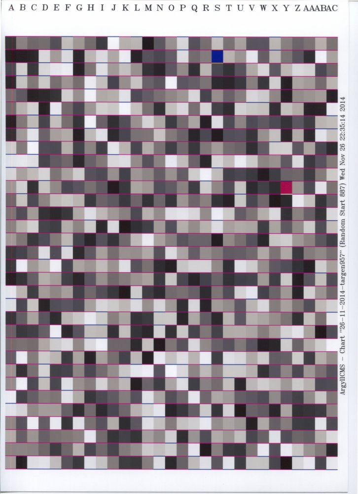

Experimenting with the targen command, to see whether the balance between B&W and colour could be beneficially adjusted, I tried an extreme case to evaluate the results of a totally grey patch set:-
targen -v -d2 -G -e4 -B4 -g949 -f957 %pcn1%
in the CAP957 batch file.
This should give 957 B&W and grey patches:- 4 white, 4 black and 949 grey.
This is the resulting scan of the 29 x 33 patch .tiff file printout. Nine hundred and fifty five B&W and grey patches and one red and one blue patch! (Why the red and blue??)
I haven't yet worked out how to evaluate the results to determine if the spread of grey is even. It probably will involve reading the patches and examining the distribution of values, rather a tedious process!

I tried to read the black, white and grey patch chart with the ColorMunki Photo as usual. But it produced "too many patches" error almost every time and could only be coaxed into the occasional successful column read.
Looking at the typical A4 colour patch chart it became immediately clear that ArgyllCMS never places light colour patches in the top and bottom rows (i.e. the start and stop points) on the A4 sheet. By restricting the chart to greyscale patches only, the software had been allowed to place near white patches in these two rows. This had the affect of disrupting the patch reading process.
I have now produced another CAP957 chart with targen -v -d2 -G -e8 -B8 -g319 -f957 %pcn1%, i.e. 8 white, 8 black, 319 grey and 622 colour patches and it is very noticeable that the top and bottom rows are made up of the darker colour patches.
Hopefully, when these have dried I will be able to read these columns and make a judgement as to the effectiveness of the increased proportion of greys.

Perhaps I should point out for those unfamiliar with ArgyllCMS and its procedures, the patch sheets in posts 1 & 2 are the starting point of the process and are printed with no colour management. These sheets are subsequently read by ColorMunki or i1Pro and processed using ArgyllCMS software to generate data from which profiles can be made. The colours visible merely show the 9000 II's interpretation of ArgyllCMS patches without colour correction.
My purpose in this thread is to eventually show the results of varying the colour to B&W patch numbers ratio in the targen sheet of patches. This will hopefully, improve the B&W linearity in the profiles generated with the modified targen parameters.
No significance should be placed on the colours of these patch sheets at this stage. It is possible to down load the images from the PrinterKnowledge website if required.
