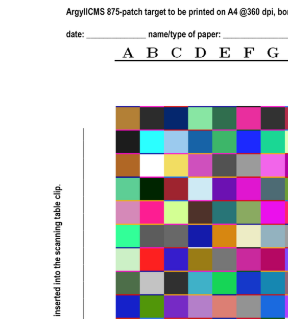

@pharmacist ,
In your profile documentation you mentioned that you recommend Qimage for printing. Did you also use Qimage for the extra human readable text? if no or yes how did you add the text? :)
And how do you prevent that the photo not get tagged with a color-space?
to all who know the answer.
In ArgyllCMS in printtarg you can choose the patch separation. But these separations can cause random read errors. version 3.4.0 can now detect them. And if you sure that the the strip-read is ok you can choose for continue. But then you do not know if all patches are read? Or is the complete row check done first? and then the DE check?
The problem is now the color separator is not to be trusted. And also the black can give sometimes high DE warnings. And no separation can false patch count trigger when a white patch is on the first or last place of the row is placed.
I have a look at the X-Rite patch chart. And they have a vertical black line at the start and end of the patches. Perhaps it is a good idea to add this option into the printtarg program? if this is not possible? then i need the add the two black lines in the generated tif in a photo editor. (with the extra readable text). :)

I am not sure what you mean by extra human readable text: please explain it to me :) . Alternative older versions of Photoshop like version 5 and older can also be used, because these older versions can print without color management. Not sure why the latest versions disabled no color management, which is very annoying.

I’ll try to explain :)
You’re by ArgyllCMS created 875-target.tif is normally without any text. Yours have text on it where we can write extra meta data about the target. It looks like you have a template where you paste the target in.

OK I understand: actually I have used my limited PS skills to squeeze and modify the orginal target using virtual paper sizes much larger than A4 and turn them into a convenient target on A4 that is optimised for the i1Pro2 scanning table and afterwards I add those extra text lines to make it a kind of entry form that is very convenient for documentation.
