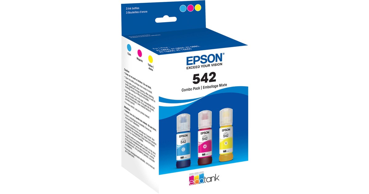

Hi.Here is the answer from AI Grok
No, not all Epson EcoTank 542 ink bottles sold without their cardboard boxes are necessarily non-genuine, but the absence of the original box is a major red flag and makes authenticity hard to verify. Official Epson sources and guides emphasize that genuine inks are packaged in cardboard boxes with security features like holographic stickers, QR codes (scannable via the Verify Epson Ink app for confirmation), and specific visual cues. Epson does not sell loose bottles without boxes through official channels.
In practice, bottles sold without boxes (especially on platforms like eBay, often vacuum-packed loosely) are frequently counterfeits, as fakers duplicate the bottles but skip or poorly replicate the box's security elements. However, it's possible (though uncommon) for a genuine bottle to end up without its box if it was removed after purchase, such as in resale or bulk scenarios. To check authenticity without the box, look for other indicators on the bottle itself:
- **EcoFit key design**: Genuine bottles have a unique keyed spout that fits only the matching color tank on Epson printers.
- **Label quality**: Labels should be firmly attached, not sliding off easily. Look for an engraved Epson stamp on the bottle bottom.
- **Ink appearance**: For pigment inks like the 542 series, the liquid should be opaque and milky (not transparent like dye ink).
- **QR code on bottle**: Some regions have a QR code on the bottle (sometimes under a paper label); scan it with the Epson app, though it may not always work reliably.
- **No generic parts**: The spout lock should be Epson-branded, not generic. If any of these are off, or if the bottle "slides around" in vacuum packaging, it's likely fake. To avoid risks, buy directly from Epson's official store or authorized dealers, where inks always come boxed.
For visual reference, here's what official packaging looks like (combo pack shown, but individual bottles follow similar boxed format):
