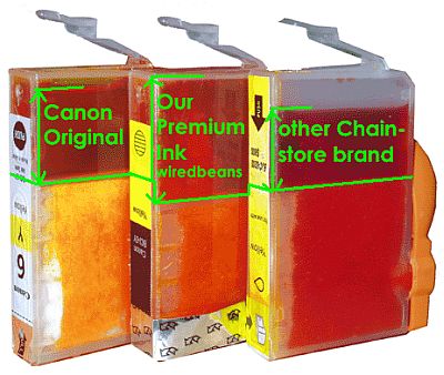

There has been recent discussion on the WiredBeans / AcuJet cartridges (see here: http://www.nifty-stuff.com/forum/viewtopic.php?id=28&p=8 )
It seems that a few of our contributing members have used, or will be using / trying these cartridges, so I thought I'd start a new thread.
I'll be receiving a few of these cartridges as well and will post my experiences here.
They state they have more capacity than standard carts:
