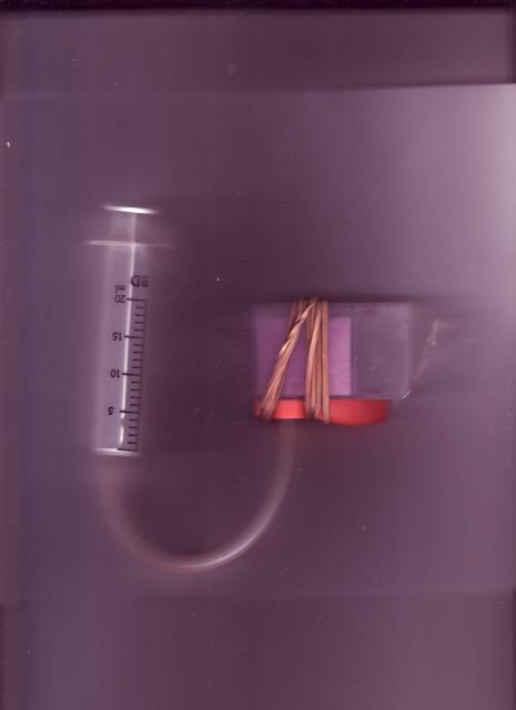

I wonder if I got the links messed up trying the Word-Link button, or if it just is the link to the Danish Google translate site that is the problem ? The link to the original russian site is here : http://master-print.info/?art=35 . I hope that shows a lot of pictures. You will then have to do the Google translate yourself, as my link dosn't seem to work properly. The subject of the site is various methods of refilling PGI-5/CLI-8 carts, some very creative.
You are absolutely right about drawing 10 ml of air out of a cartridge with 10 ml of air in it only removes half of the air, so at most 5 ml of ink will be sucked into the cartridge and the process will have to be repeated many times. Out of curiosity I actually made a simple set-up similar to the Russian idea and tested it with a flushed BCI-6 cartridge and water instead of ink. It took about 10 operations of drawing air out and letting ink in, and I had to disconnect the syringe and squeeze air out several times. I finally got the cart filled, but it was very inconvenient and it could have been very messy if I had used ink for the test. Here is a scan of my clone of the Russian set-up http://www.nifty-stuff.com/forum/uploads/6881_scan10003.jpg
The bottom fill test was an answer to ThrillaMozilla's question in this post : http://www.nifty-stuff.com/forum/viewtopic.php?pid=40309#p40309 . A YouTube video of bottom filling a HP 564 cart is here: http://www.youtube.com/watch?v=L_319LYlfBY . I tested this method and found it was no good for a Canon cart, so I share your suspicion of bottom fill methods.
The relation between the bottom fill method and the vacuum fill methods described in this thread is that the vacuum fill methods also fill through the outlet, but with vent sealed, either by a jig or a simple piece of tape.

I have used this type of vacuum filling with the InkTec apparatus for HP 564, and I'm pretty sure what is described in the videos will work, as long as they take certain precautions that they omitted. I'm neither endorsing it nor not endorsing it. I'd say it's experimental, but it may actually be a good way to get air out of the sponge.
I used it successfully in tests, and was able to immediately fill and drain a cartridge (slowly with a towel) with the correct amount of ink. I talked about doing this a long time ago in several posts, but you guys didn't much like the idea, so I didn't report further. ;) I used it on HP564 cartridges (non-XL, sponge only), but I have no doubt that it can be used for the larger, XL cartridges, as the video proves.
I think you all understand it pretty well, but I can summarize it, and maybe add a couple of details.
1. The cartridges must not have any unsealed holes except for the vent and outlet. You need to seal the (serpentine) vent while filling. You probably will not be able to seal it perfectly, so you may have to clean it afterwards. I drew a little air through it, then cleaned the outside of the cartridge with distilled water, and drew a couple of drops back through the vent to clean it.
2. To fill completely, you will have to evacuate more than once. You will need to cycle at least two or three times or more to fill completely. Don't press on the plunger. Just evacuate and let the syringe pull itself in.
3. Figure out which side should be up. During the evacuation stroke, you want the air side up, i.e., you want air to feed through the opening between chambers. During the fill stroke, you want ink down (so it can run from the syringe).
4. Watch out! You may end with the sponge overfilled. Using the syringe, you can remove a little ink from the cartridge (you need to know how much the sponge chamber holds), or you can drain the cartridge in the usual way, letting it drip, (I would THEN draw still a little more out).
5. I would let the whole think equilibrate for a while. How long? Darned if I know. 10 minutes? Half hour? 2 days? Make darned sure it's not going to drip.
Caveat: I haven't tried this with XL cartridges, but with HP564 cartridges, which have a sponge only, no ink chamber -- but I'm sure it will work. I haven't used ANY of these cartridges in a printer yet, as I don't just refill every day. Sorry, I also don't have a video for you, since the work is already done.
One other point re HP564/364 XL cartridges (and maybe similar Canon cartridges). The HP564 cartridge has an opening between sponge chamber and empty chamber. But this is on the same side as on the vent, whereas the XL cartridges have it on the same side as the outlet. Make sure you don't fill this empty chamber by accident--although there may not be much harm in doing so.
