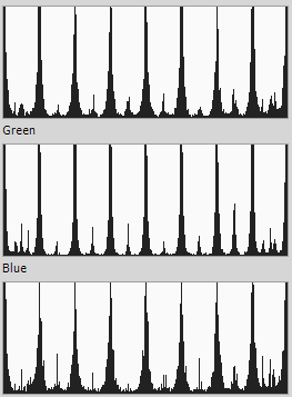

I wouldn't use a .jpg (this one was saved as a PS level 6) for a color chart because the compression affects the colors of the pixels, as shown by this detail. This is a particularly bad area, but it shows that even the colors deep within a patch can be affected.
This is the histogram for the .jpg, showing that there are lots of pixels that have been affected, some by quite a bit.

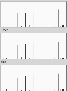

For reference, here is the histogram from the .tif - that's why this lossless format is used to save color charts.

Well, I wouldn't have believed it. But as you say those colour discontinuities could easily influence the colour reading. So the practice of sending a .jpg patch file by email to generate a profile for someone is possibly going to deliver a sub-standard result. As the email limit is typically 10MB it would not be possible to send an accurate .tif patch file without compression.

True, but since the LZW compression of a .tif file is lossless, just compress it. When computers were much slower and not every OS made it so easy, it may have taken a little time and effort to compress/decompress a file. Today, there is no reason not to compress a .tif file.
