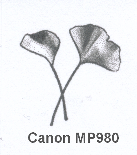

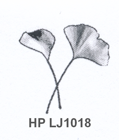

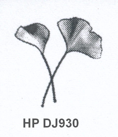

I downloaded the attached image and printed it. The printed image is approximately 3/4" x 3/4" or 20mm x 20mm. Is this correct?
I have printed the Ginkgo-test image on a HP DJ930 and a Canon MP980 inkjet printers and a HP LJ1018 laser printer. All printers used 600 dpi resolution, but the images are different. Here are 600 dpi scans made using the CCD scanner in the Canon MP980.
Even if the 3 printers printed the same file the result is different. The printers seem to process the image file differently.
I have printed the Gingko-test image on a HP DJ930 and a Canon MP980 inkjet printers and a HP LJ1018 laser printer. All printers used 600 dpi resolution, but the images are different. Here are 600 dpi scans made using the CCD scanner in the Canon MP980.
View attachment 14215View attachment 14216View attachment 14217
