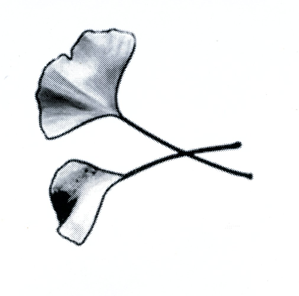

Why does my old HP 6L print images better than my newer HP laserjets?
5,250
5,155
......Just the image itself is about 15cm tall, and I print at 94%.
I have downloaded a thumbnail instead of the image, The image prints at 15 cm x 15 cm or 6" x 6". My prints then look like those printed by The Hat, Here is a 75 dpi scan of 3 prints joined, click to enlarge:

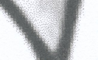

I have made 1200 dpi scans of the small red rectangles, this clearly shows the difference between the 3 printers. Notice the two HP printers have a very newspaper image like print and the Canon inkjet has a much smoother image. Top is HP DJ930, middle is HP LJ1018 and bottom is Canon MP 980. Click to enlarge:
It seems that number of dpi alone doesn't tell all about print quality. How the printer processes the image file seems just as important.

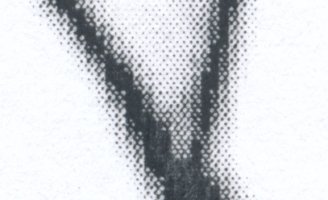

I have also been confused by the Ginkgo Test image. Copying and printing it from post #6 produces a 20mm x 20mm print, but opening the image in a new tab and copying it produces a 15 cm x 15 cm print, so the image in post #6 is a thumbnail I think.
A 300 dpi scan of the thumbnail print made by the HP Laserjet 1018 looks very similar to the right hand print of post #1:

I'm sorry - there was a typo on my part. For me, the image alone is 1.5cm in height and I print it at 94%. I am surprised that it is printing so large for you. Sorry to use up so much toner!
And that is also why I am surprised that I can't get the image to print without dots or lines on my other hp laserjets - just the 6L.

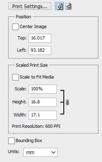

No your problem is I reckon, that you don’t quite understand how PPI and DPI work.
Your increasing the DPI in your print instead of leaving it at your normal 600 DPI, the answer is to enlarging the image itself twice or three times its size and then reduce it in the print driver back to its normal size, that’s the size you wish the print to finish at..
Instead of printing it to PDF, try saving it to a PDF file and then print the PDF from ACRO Reader..

Yes, I would typically leave the document print size at 8.5" x 11" etc. but increase the resolution.
This time I kept the dpi of the full document to 300 with the page size at 25.5" x 33" but printed 'to fit' a 8.5" x 11". The print resolution showed as 943 ppi. I also tried 600 dpi with the page size at 34" x 44".
It didn't improve the print quality in any significant way - I can still see lines and dots - but is this what you meant for me to try?
