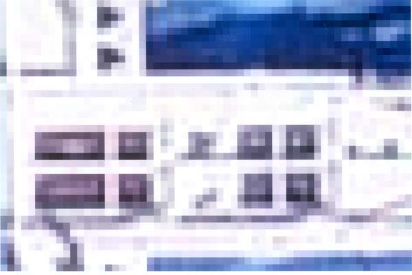

I highly recommend reading the information published on this subject by Mike Cheney (previously referenced by ghwellsjr). Understanding this subject involves looking at how the pixel data is handled by the printers driver. This image:
is a 40 x 60 pixel sample (taken from a larger photo) that has been blown up 10:1. It shows pixellation the individual pixels are clearly visible.

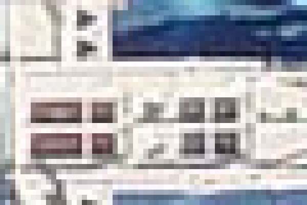

This same 40x60 pixel image was printed at 4x6 inches (10 pixels/inch) on a Canon i9900 using the standard Windows printing package (which just passes the pixel information directly to the printer and is not color managed). The print was then scanned at 100 pixels/inch (to keep the image size down):
Note that the printer made no attempt to upsize the image it just printed each pixel as a large square with a constant color.

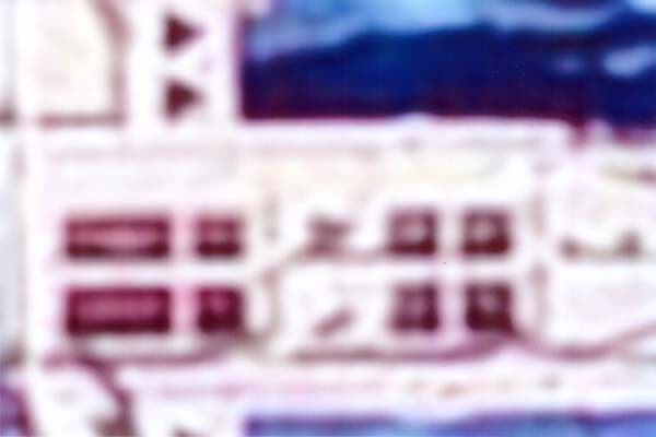

The same image was then printed using Qimage, which is set to automatically upsize each image to 600 ppi on my computer (equivalent to upsizing the image in Photoshop or GF, then printing through Photoshop):
It is easy to see that the upsized image gives a much more pleasing result. If you want to get the best results from your images, paying attention to these details will help. It can be argued that a print from a 300 ppi image is as good as a 600 ppi image 99% of the time, but Qimage does it automatically with no effort on my part.
