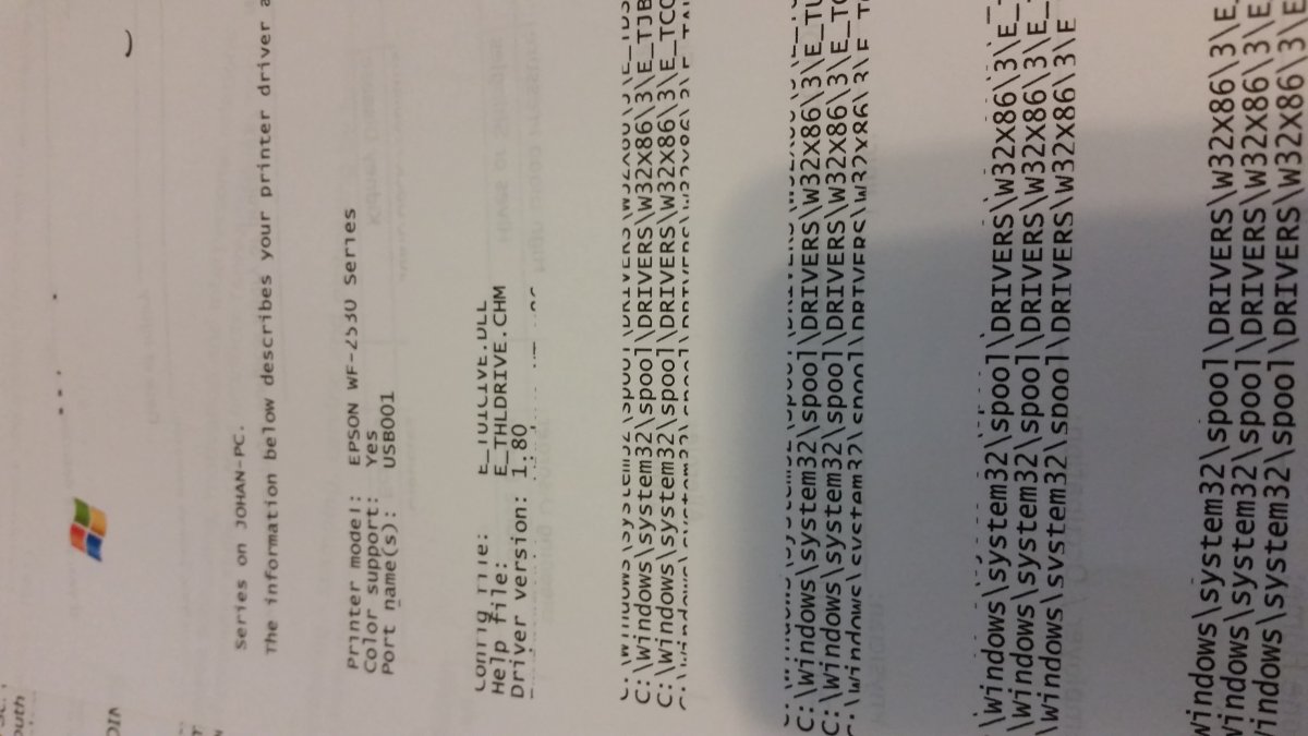

Wow,
Quite a few hours invested in this problem so far -PLEASE HELP!!
The printer prints in bands across the page - it simply skips every other half inch of printing. It is not as if the printing is spaced out - it is as if it prints every half inch, blanks out the next half inch, prints half inch again and so on down the page.
I have replaced the ink cartridges - I have downloaded the latest driver - I get the same results from different software - I get the same results when using it as a copier.
I have restarted the printer and the computer.
I tried contacting the Epson support, but their "sending a message" page opens up without a Submit button!!!
The attached photo is what the printing looks like and another is what their support screen looks like.

OK, I attached a jpg of a test print.
Thanks for your help - I really appreciate that.
6,205
7,390
It appears to me that a range of nozzles is missing, those for black, please run the nozzle check via the
driver, run a cleaning cycle and run the nozzle check again to see whether there is any change/improvement to observe

The nozzle pattern came out fine, but I did a nozzle clean and took the cartridge out and placed it in again. Ink charging now so I hope that all helps!
JohanP
Oct 25, 2015
Epson WF-2530
SUCCESS!!!! You guys rock!
