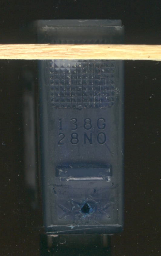

Hi Fabfoto
I agree with The Hat that reading up on refilling is a good idea, before starting refilling. So here is some suggested reading and a couple of tips.
As the sealing of the refill hole is very important to avoid ink leaks when topfilling ink cartridges, I suggest you do not drill the cartridge to use the low clearance plugs. : http://www.precisioncolors.com/Using the Newer Low Clearance Plugs.pdf Instead I suggest that you use the zero clearance plugs as they require no drilling: http://www.precisioncolors.com/Using the Zero Clearance Plugs.pdf
As it is difficult to drill a perfect round hole using a hand held drill, the low clearance plugs might not provide a perfect seal. See this picture of a less than perfect hole drilled using a hand held cordless drill, click to enlarge:
Also the cartridge clearance is very low on some newer canon printers, so I recommend the use of the zero clearance plugs plus aluminum tape.
For topfilling the cartridges, see these threads: http://www.nifty-stuff.com/forum/viewtopic.php?id=6264 http://www.nifty-stuff.com/forum/viewtopic.php?id=7915&p=1 and this instruction: http://www.precisioncolors.com/Canon instructions PGI-220CLI-221.pdf
For making handling the zero clearance plugs easier, here is a tip: http://www.nifty-stuff.com/forum/viewtopic.php?pid=56693#p56693
The wooden toothpick/cocktail stick is also useful as a dipstick to gauge ink level, when topfilling the opaque PGI.225/CLI-226. But refilling can be made easier if you swap your chips to the windowed PGI-220/CLI-221 cartridges. These cartridges are also available from Precision Colors: http://www.precisioncolors.com/c5ccart.html
Instruction for chip swapping here: http://www.nifty-stuff.com/forum/viewtopic.php?pid=41631#p41631 . When swapping the chips only swap one at a time, the chips are coded for color among other things, so don't apply a chip to a wrong cartridge.
I hope this improves your changes of a successful first refill. And as The Hat says: Happy refilling :)
