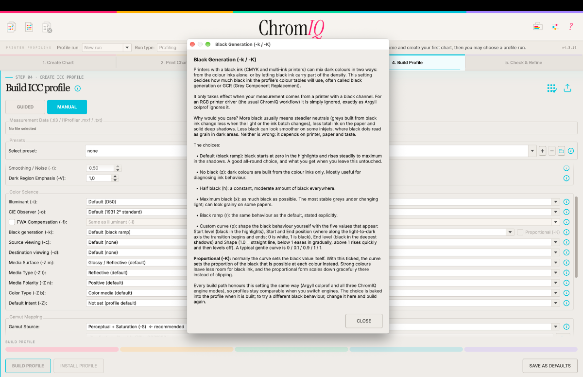

Well I made this whole app with the help of AI because I myself was not able to use Argyll in the commandline. So I trusted Claude to offer every option of every part of Argyll that makes sense for printer profiling so one does not have to remember it. There is the following option in the build profile tabs manual module (= colprof), howeer I think this only applies to true CMYK and CMY+N printers:
