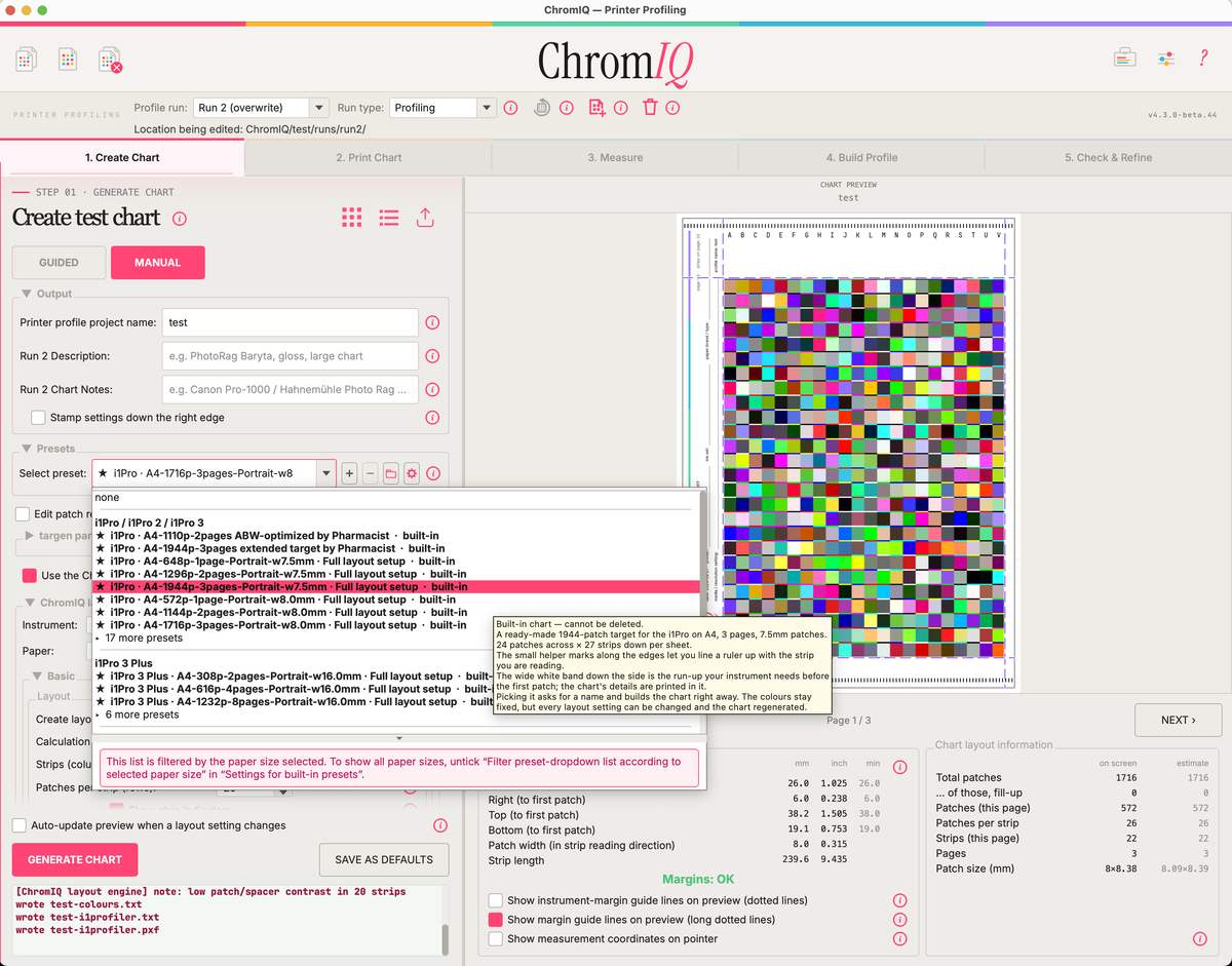

Hi @pharmacist,
ChromIQ Version 4.3.0-beta-44 is out. You can now see how the preset list looks like, and it seems to work nicely.
There is considerable less profiles in the list now, and it is configurable for anyone to change :)
Also, I know you are helping to make your own suggested charts into our built-in chart presets, so that they can load with all settings and the patch set engine settings used... You asked about adding an image as the clip-border. Just wanted to say that in the Expert Options section in the Manual mode Create Chart tab, there is the Clip-border content frame that contains settings to customise the clip-border. Under the pulldown list for "Content" you can select "Imported Image" to add an image. You know this, but what is new is that you can select "ChromIQ branding", which adds the ChromIQ logo, and then you can add any text that you want in the text field, and those "Inserts" you can add, for page number, patch size, or whatever, they are updated automatically. If you add an image, it is a static thing.
As an example, Select an i1Pro preset (all of them use a clip-border Notes box). Go to Expert Options section in the Manual mode Create Chart tab and to Clip-border content frame (bottom of the list). Select the Content option "Custom text example", which puts an example into the text field. Then select "ChromIQ branding" and click Generate chart.
This can then look like this (I modified the example text a little):

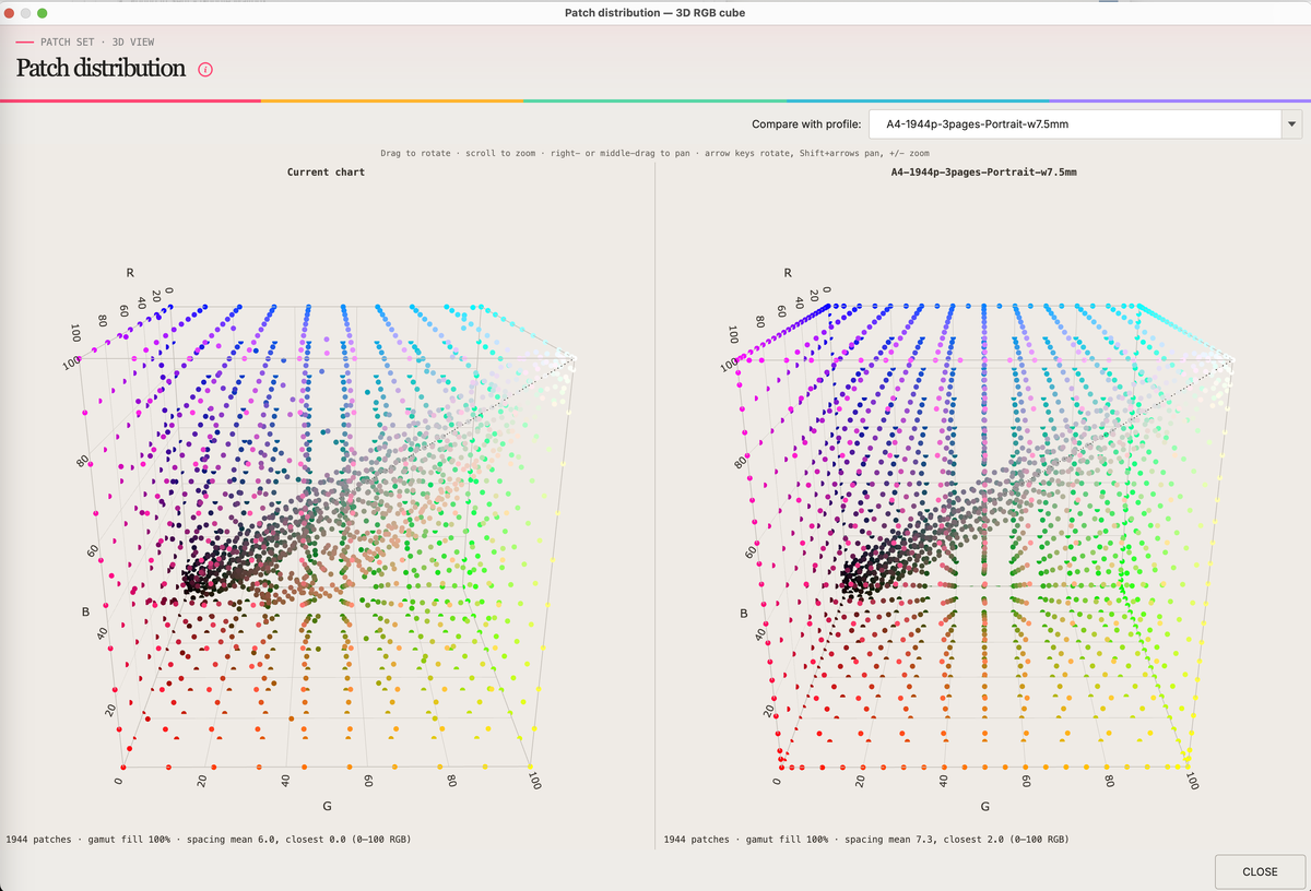

Here is a comparison of the two patch sets, Pharmacist's on the left and the built-in preset version "i1Pro · A4-1944p-3pages-Portrait-w7.5mm" on the right:
A disadvantage of the profiles by pharmacist, which he is currently working on to fix, is that they do not contain any layout information (only images), which make them hard to use as basis for a new layout.

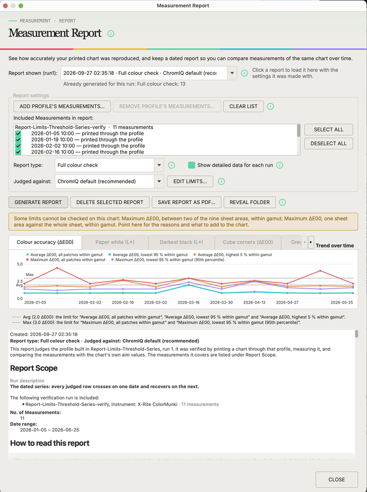

To your comment on a one-pager for control: We have designed a workflow in ChromIQ that allows regular control measurements of a profile (we call it a verification run), which then outputs a report, from the tool "Measurement Report" in the tools menu.
Attached is an example report made on demo data, as I do not currently have any real data measured over time to get all the trend-graphs.
And here is a screenshot of the Measurement Report window for the attached report:
Sebastian and I hope the community can test this feature and report back the results... There are many options to customise limits for each metric checked, and there are 20 different metrics to choose from. Here is a view of the setup window that defines all the metrics and thresholds (all 20 does not fit into one screenshot, as the window scrolls):
