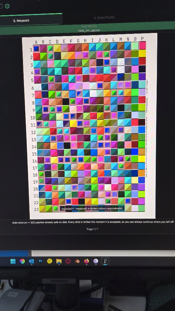

I am trying to remeasure some patches, because I see there are severe Delta E errors in the patches:
I finished scanning, but I want to reread H5 and I13 again....but it seems everything or not.....Maybe @itsab1989 you can tell me how to only remeasure those points without doing everything again.
On the left - is resume / refine existing measurement selected? And then you should be able to click on the patch you want to measure

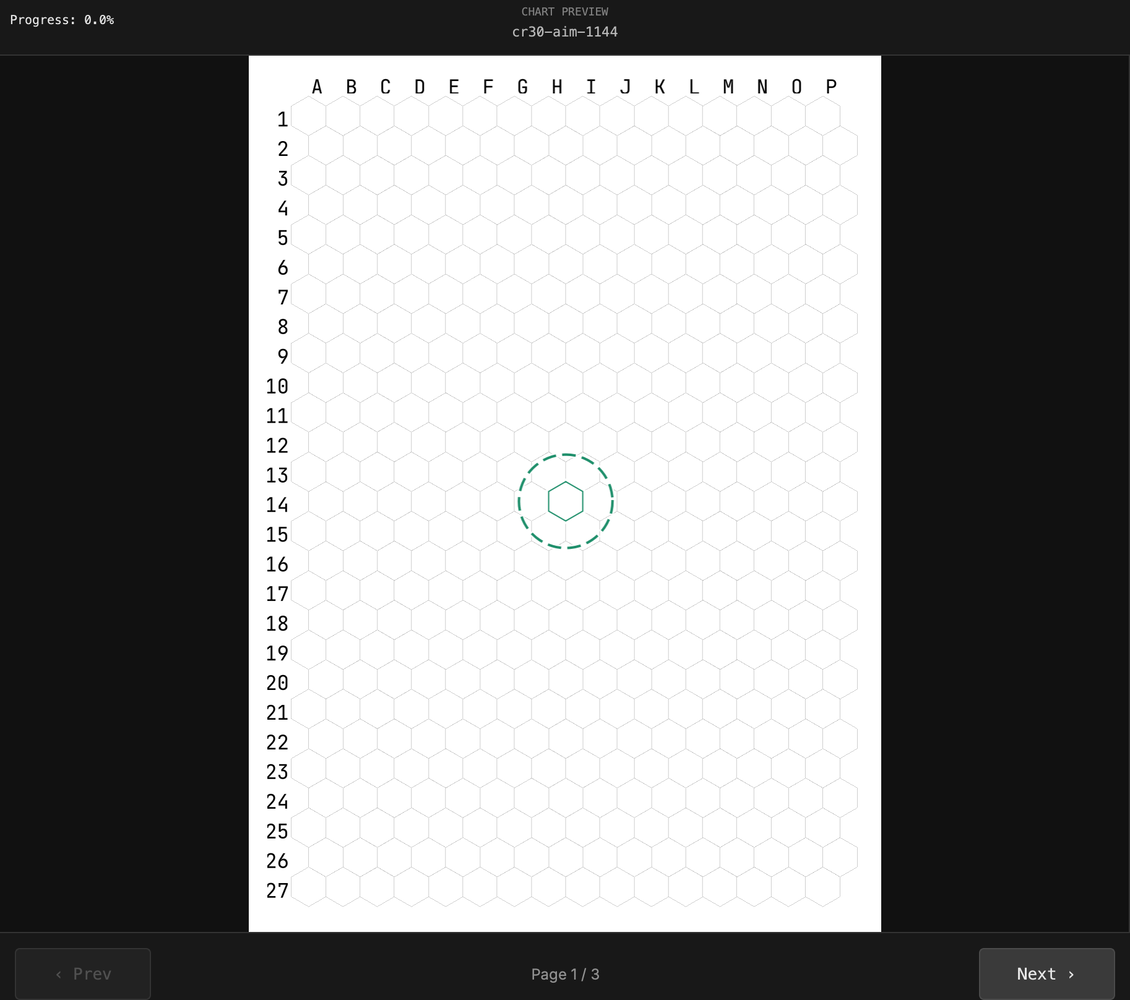

Working on an aiming help in case you want to try smaller patches:
