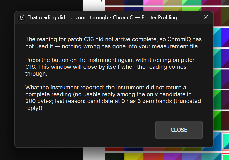

I do run into some issues when using my CR30: when measuring the most saturated patches on my chart, I get the message below. The error is reproducable and happens only when measuring on glossy or satin papers. The same patches printed on matte paper measure just fine.
I believe this is not a real error, and that the 0-bands might just be coming from a very saturated colorimetric value.
Currently using the latest beta + Canon IP8770 with oem inks.
