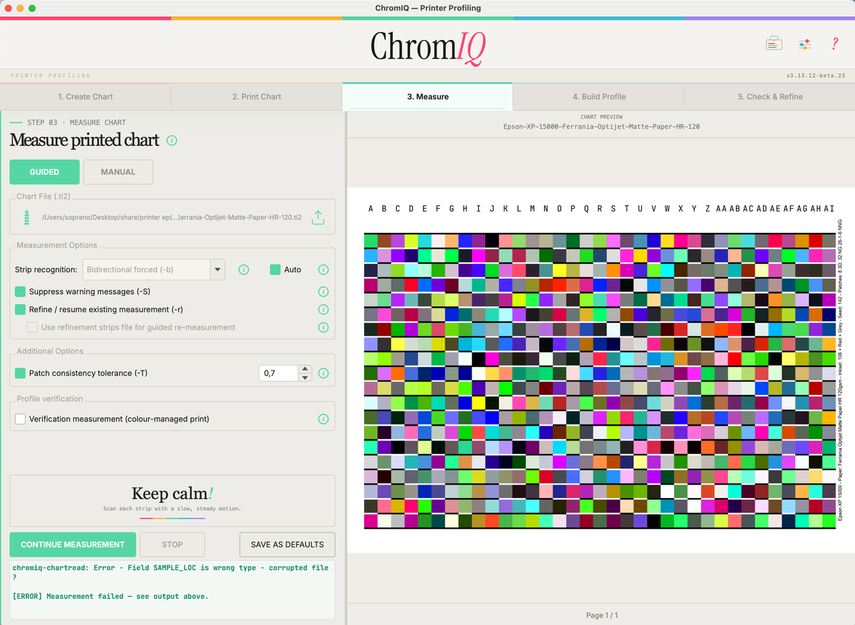

@itsab1989 maybe a little bug,
if i go on measure chart, then try to load a ti2 file it gives error i will add the 3 screenshoots for you
i suppose it is not using the right mode, it seems to open the finder on mac sequoia
Beta23

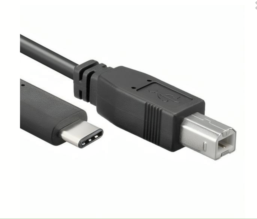

@mavtop : Did you use something like this for your i1Pro1:
A direct usb-c to printer cable, or do you use a converter from usb-c to usb 3.0 ?
i use an usb-b to usb-a cable, that shipped with i1pro1 direct to an usb-a port on my istudio (it has usb-a port), while on the notebook it is attached to an 8in1 usb-c converter, on the imac 27 it is connected to an usb-a port.
