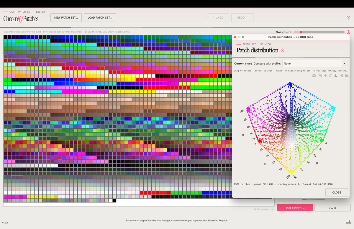

Someone requested that I should add a GUI for collink as an additional tool. This was a pretty easy task so it is included in the latest beta. Maybe some of you know what this is really good for 😅

@pharmacist - I made three profiles for Ilford Galerie Satin Photo paper for use with my Epson SC-P600. One with 484 patches and preconditioning. The other two with 1160 &1944 patches - only one run. All three targets could be measured without any problem with my old i1Pro. For me all the profiles are equally fine. Visually they appear nearly identical. The 1160 patches profile without preconditioning is a little smaller in gamut, but the printed test image is absolutely useable. I'm very satisfied with the results. All three targets resulted in nice profiles.
Thanks a lot for your work!
Ronald
Ronald
You are welcome: you should thanks Sebastian and Knut for the programming. I am only designing and constructing the printer targets.
Yes, for sure my thanks are also going to Sebastian and Knut. I really appreciate the whole project and for me it's a big step forward getting better profiles. The last years I used the Spyderprint package from DataColor, but the results were never as good as with ChromIQ. I think the quality of the targets are an important fact to get really good results.
Ohhh, that terrible SpyderPrint package: I think the problem is really in the software creating the profiles....I think if ArgyllCMS would have a SpyderPrint driver the results would be much better. The spectro is -I think- not the problem but the software.
Agreed. The spectro seems to be a quite useable instrument, but the whole software flow appears not really thought out. The targets are also not so smart. You got max 729 patches and it uses 3 to 4 pages. Glad I switched to an old i1pro device and Argyll CMS.
