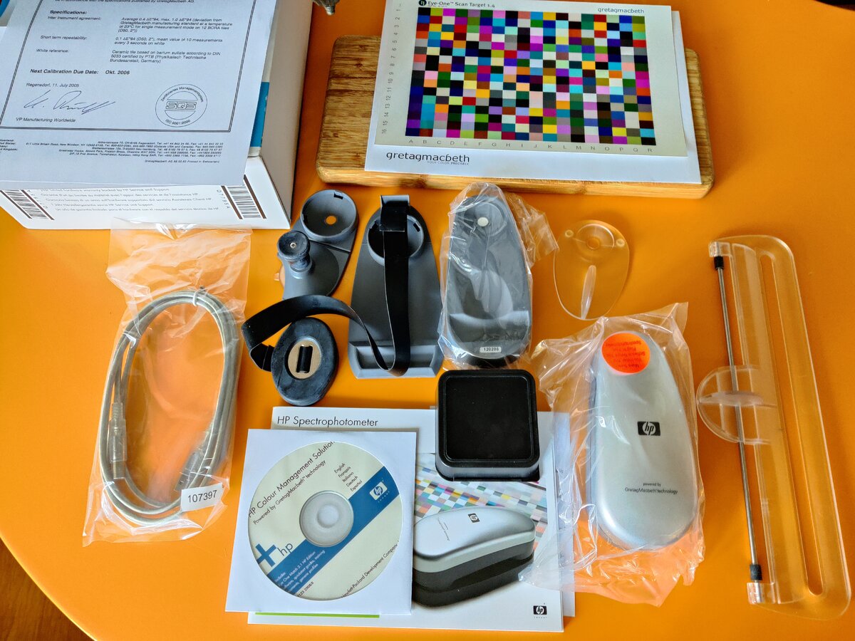

I have a rebranded i1Pro 1 rev A (HP spectrophotometer), that I found on the local second hand site, completely sealed and unused for a bargain price and best of all: it has that precious license for i1Profiler for printer profiling. Only the scanning jig was the first version without the scanning board, for which I have 3D printed a custom jig, that is way more ergonomical.
The 3D printed scanning jig prevents touching the (printed) paper surface unlike the older simpler version where you have to scratch the paper surface when scanning, potentially damaging the color patches.

Wow this looks nice. I wanted to buy an i1Pro3 from a guy in Poland. He told me it was completely new, locked in a drawer and never used. But when I got it it showed clear signs of use. Suddenly his wife wife or coworker might have used it once or twice…
I returned it because I did not have a good feeling about it.
