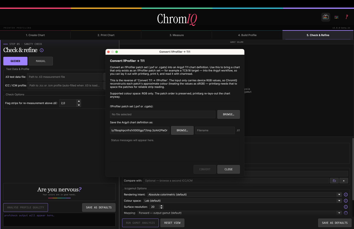

@pharmacist
Want to add an additional thing and then upload a new beta. You have to test this because I lack the knowledge to figure out whether it is good or not.

@pharmacist
It is online:
https://github.com/itsab1989/ChromIQ/releases/tag/v3.8.0-beta.15
I disabled the TC9.24 targets for now. I think I will make this the new stable release soon if there are no mayor issues.
Edit: Conversion is not working that good. Trying to improve
Edit2: have a better version now but in the process I noticed that some options for targen were still missing although I let Claude check targens documentation multiple times already…

@pharmacist
Beta 16 is better. Conversion is much improved and more targen options for you to play with (can't save them as default or preset for now. I hit 100% usage limit and wanted to get this out instead of waiting longer until the reset. Look for a beta 17 before downloading in case this is already fixed before you read this post):
