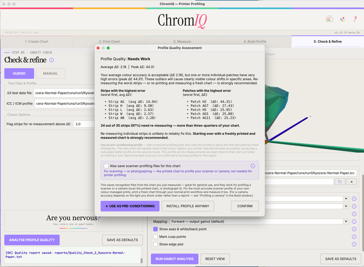

Good and bad news (also if i don't know if they are really bad)
i got an old USB2.0 hub with the port to power it, it says 5V 2,5Ampere, but i found only a 5V 1.0A power switch and i used it
Finally the i1pro1 now seems to work, but i don't know if it is working good or not.
I succeded to pass the calibration test and the patch reading i used a new profile created for my office Kyocera Printer with Plain Paper (and maybe the problem if it exists is the type of paper used) and a new patches set that i created based on @pharmacist for grey gradients and neutral (scrrenshoot attached).
Before reading all the patches i tested spotread to read the white of the paper more times and each time the value changed, but i don't know if the differences between them are important (to indicate still no enough power from usb hub) or are just normal.
I used chartread from ArgyllCMS later i will try to reread it with the Chromiq engine and its chartread just to compare the two reading and the two profile.
Finished the reading i built the profile (i didn't change anything) and analyzed it
The answer was that 97% of the strips need re-mesuring (screenshoot attached).
Anyway i went on and runned the gamut analysis how showed in the screenshoot attached.
I attached also all the project files so if someone could give it a look just to verify if my spectro is running good or not.
the low black value i suppose is normal for plain paper like also for matte paper.
Now i will clone the project to read it again with Chromiq engine and its chartread, just to see if the measurement and the final ICC profile are the same or very similar.
Anyway i will try to find a power adapter with more than 1Ampere, just to verify the spectro has enough power to operate.

My first attempts with the ColorMunki were similar in terms of DeltaE. When I had more experience with handling the instrument (moving slow and steady) it got better.
The new engine will not do anything real different than regular chartread. However the real-time overlays might be a helpful indicator to see where things go wrong.
I just made a cut and released v3.14.0 as a final btw.

i have problems with the chromiq enigne, its chartread can't inizialize the i1pro1, it tells always no answer from device, i need to specify where is connected the device ?
now press key showed like old chartread and also if i press a key nothing happens
with spotread i can calibrate it and read the patches

Try to go to the beta settings and disable the fast instrument connection setting maybe.

nothing to do, again it seems no working again, argggg
i read all the strips before with no problem, and now 3 times on 4 failing calibration, then pass calibration
i wanted to test your engine but in this way i can't do it
mavtop
Printing Ninja
Nov 14, 2021
139
41
90
Epson XP 15000
anyway i'm sure my i1pro1 is good so with some AI helps i tried to test it more times, to read the same color (white patch on the basement) and see how change the delta E
the answer of the AI is that my instrument is reading perfectly, the delta E is so low for a device so old, also the test shows no problems on sensor or light
so i suppose my main problem is only the USB power that is not enough to pass the test always at the first attempt, when it passes the test then it works like it would

@mavtop
New release with a small fix should be out in 20 minutes if everything works as expected. However Claude could not really rule out what causes this. Pharmacists i1Pro seemed to work with the engine and I just tested my ColorMunki again as well. Maybe a log file would help.
