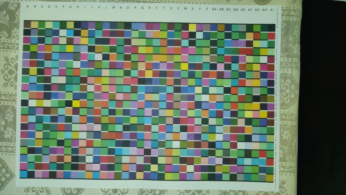

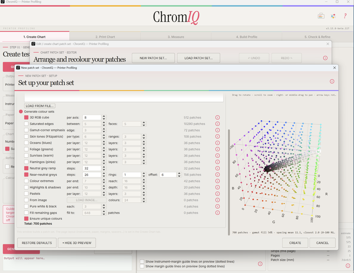

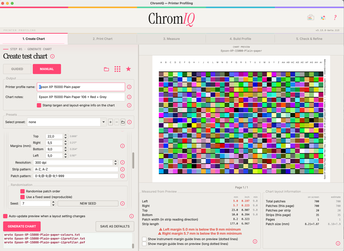

@pharmacist i used chromiq layout engine to generate this profile automatically,
but i would like to have some hints about optimizing it t have a neutral profile (if i will print BW images)
give a look to the patch size in Chromiq screenshoot and if it's good enough for my i1pro1 devices, i printed the patch chart, and i see bigger patches from my last printed and profiled, so maybe i can squeeze them more, also the blank white space from strip label to first patch is bigger than the white space at the end of the strips, maybe i can get some more patches
I have some colors over other on the edges, specially red with blu or green, but some patches have some vertical line darker, i don't know if it is an alignment problem on my Epson XP 15000, i did it the last time i changed the refillable kit, but it is not so easy to choose the best block for the alignment, they are too similar
let me know what do you think
