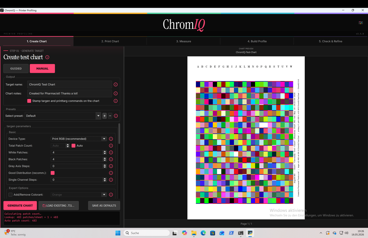

@pharmacist :
Doing a final test and the ship an update. Please test whether the profile building now works

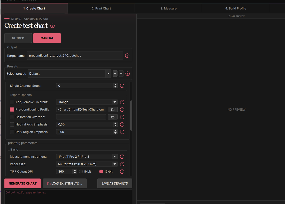

Some extra updates:
The systems hangs and does not generate the target when using a preconditioning target to generate a new set of patches. I have to close the program.
I get this:
When I hit the generate chart (with the pre-conditioning profile selected): the system hanged.
Another try again:

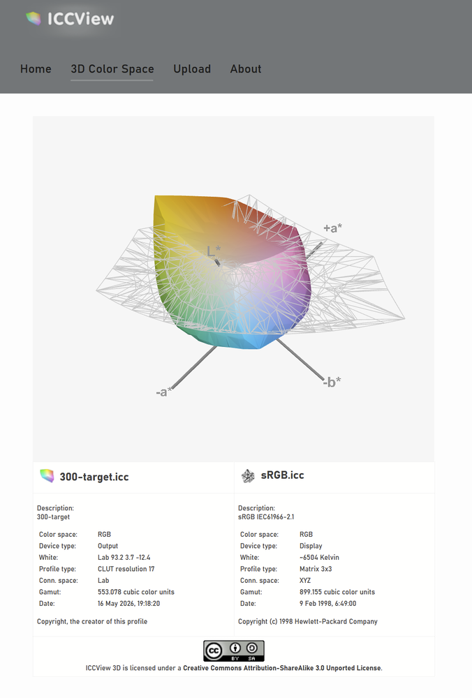

Not sure what those error messages are, but the it took a very long time to generate a simple target and this is the result in iccview.de:
Normally with only 240 patches a very good profile should be generated, but somehow the engine produces a very strange profile: the computer says NO.
3,215

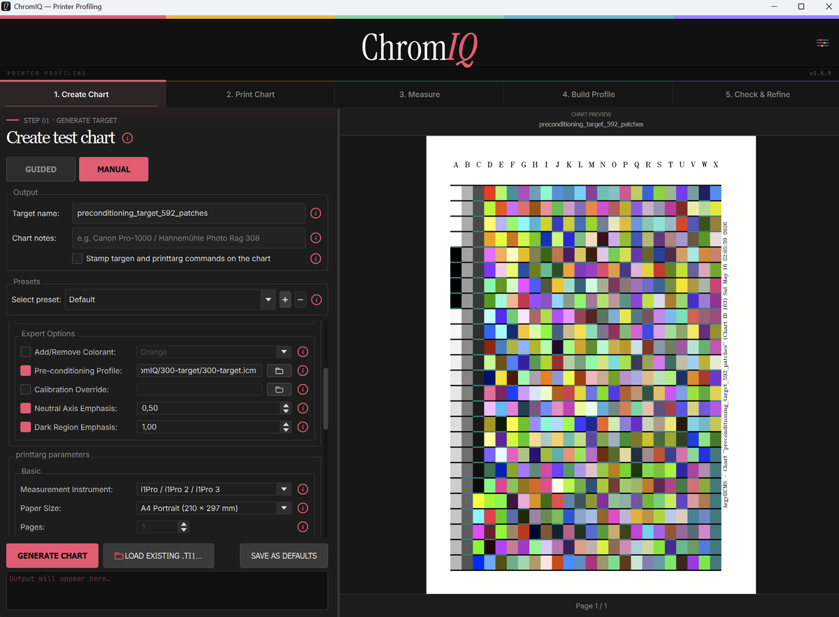

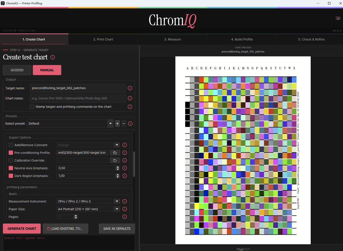

I just downloaded the latest version and I tried it again:
This seems to be nicer: also the spacing is better (within the boundaries of the scanning jig of the i1Pro2: starts on white and stops on white). But when I tried a preconditioning profile I get this:
Have a look at the dummy patches that should be white on the row X beneath: with a pre-conditioning profile those patches are now green (should be white as the spectro expects white dummy patches) and also the space bares (choosing black/white spacers some bare are now green (probably this should be white). I think there is a glitch in the patch generating engine.

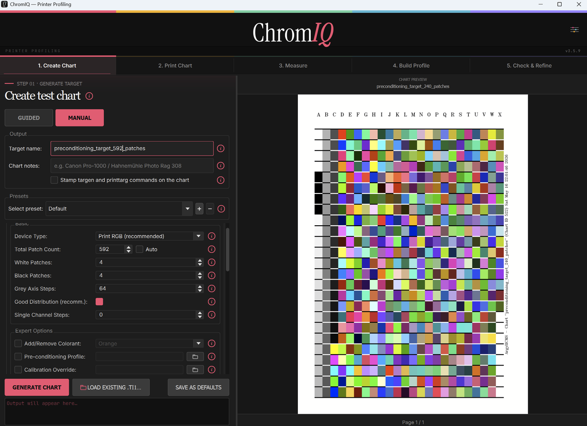

3,215
1,843
333
SC-900 ET-8550 WF-7840 TS705
OK, it was my fault: I was using the older version 3.4.1 and I just upgraded to 3.5.0 and how the green patches are gone with the preconditioning profile checked:
