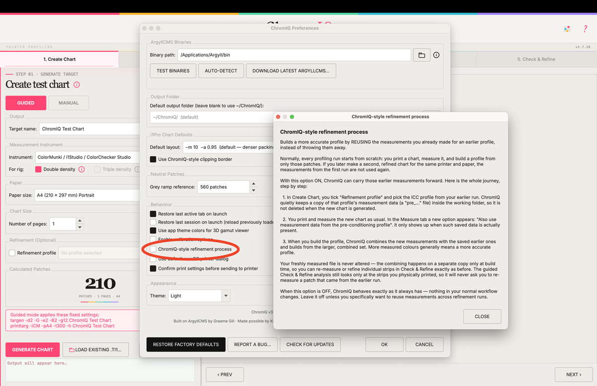

I have half boxes of papers that I do not print on any longer and am using these to play around with the app. Three of the profiles were just one page patch sets to test various settings and give you feedback. The other day I did a profile with a pre-condition profile. Yesterday and today I tested out the higher density patch set with my i1 Pro (506 patches per page at the 0.95 setting). I wish I had the app a month ago as I was testing out three new Canson papers that I might want to use for further use. My work flow was a two page patch set (924) for the preconditioning profile and four pages for the final profile (1848).@Alan G
