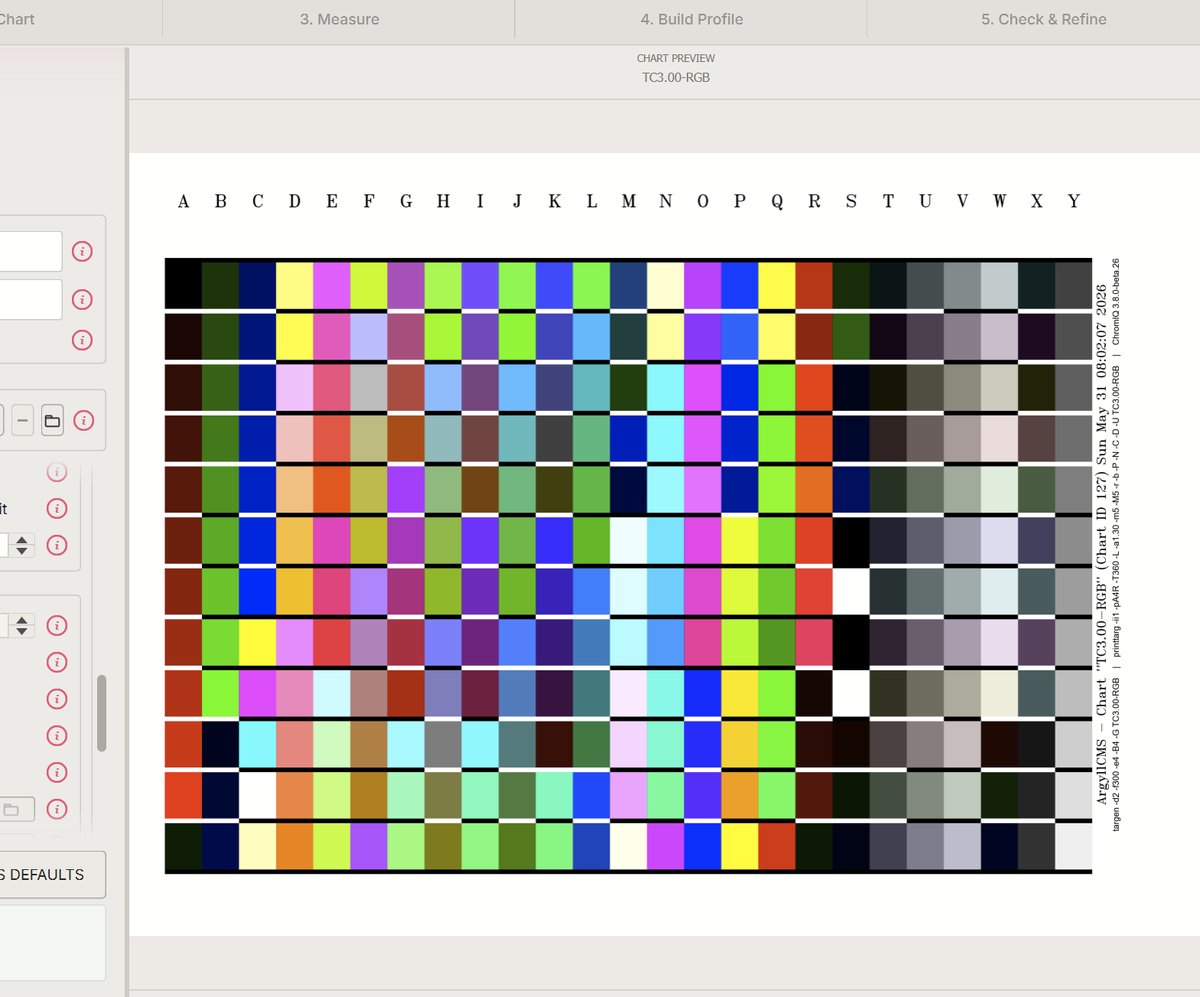

Now we know the cause of the problems. I will do some extra testing to be sure and upload some extra presets too. Most probably I will upload special randomized TC9.18 target for which I have the pxf-file.
In the latest release I loosened the restrictions with bi-directional a bit. I force it for i1Pro and give a one-time warning when it is active and a non-ranomized chart is loaded so the user is aware of this.
For the ColorMunki I did not force it but use the Argyll defaults now (neither -B nor -b).
In the ti2 layout editor there is now an option to force-tag a non-randomized chart as randomized so chartread will not disable bi-directional detection for it even if you don't use the argument to force it.
Basically the ti2 tells chartread that it is randomized although it is not (should have no influence on anything else, Claude says that it is only the tag that triggers this behaviour of chartread)
