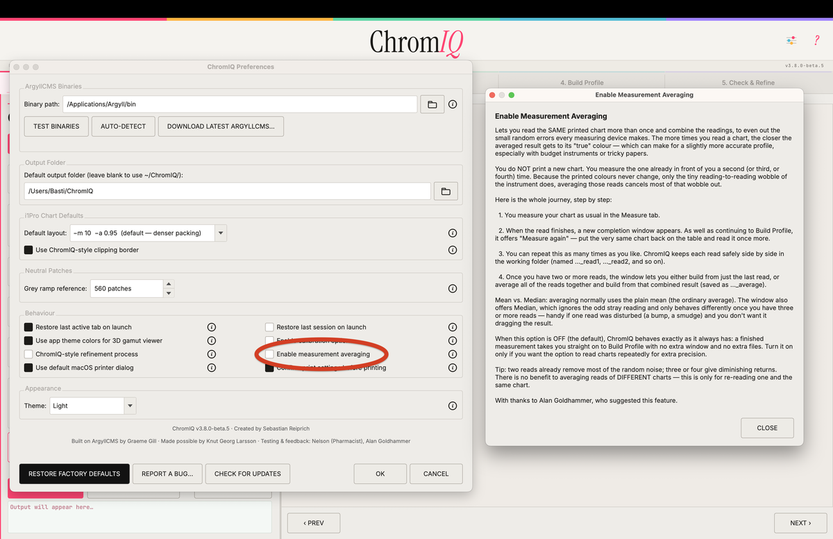

@Alan G :
This one is for you. I put the averaging only in the beta first because I was a little scared that it might break anything. Please have a look and let me know if this is what you imagined and if it works. Is the implementation in the interface good? Maybe the new options are overwhelming for beginner users. Should I hide them behind another option in the settings that is disabled by default? Let me know your thoughts! Looking forward to it!
https://github.com/itsab1989/ChromIQ/releases/tag/v3.8.0-beta.5
