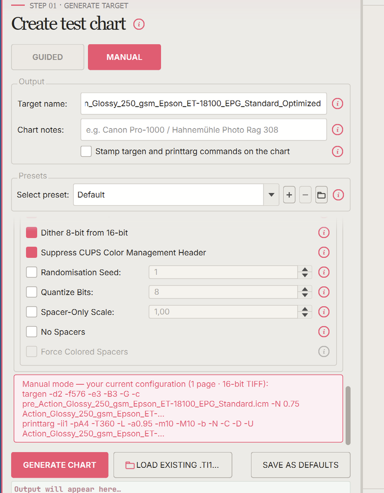

Finger crossed: succesfully read the optimized target (with the previous profiles as preconditioning):
I really hope it is working. You have a really good hand for finding bugs by the way :D
It stresses me out everytime but I think we have fixed a good number already :)
But if you want to do pre-conditioning please update the app first. I see you are at 3.7.27 and the fixes were implemented later. Sorry for pushing so many updates btw.

Yes it works:

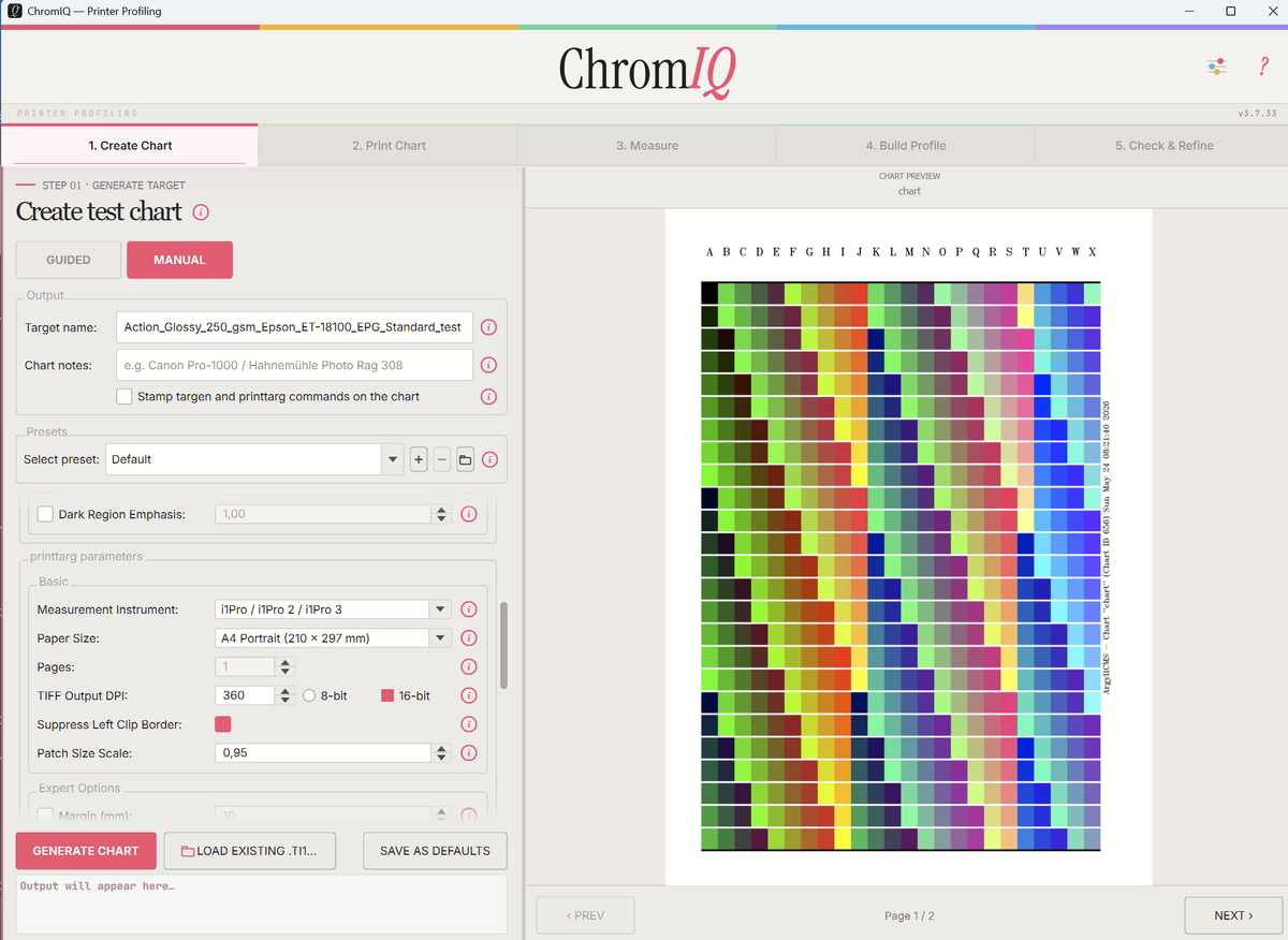

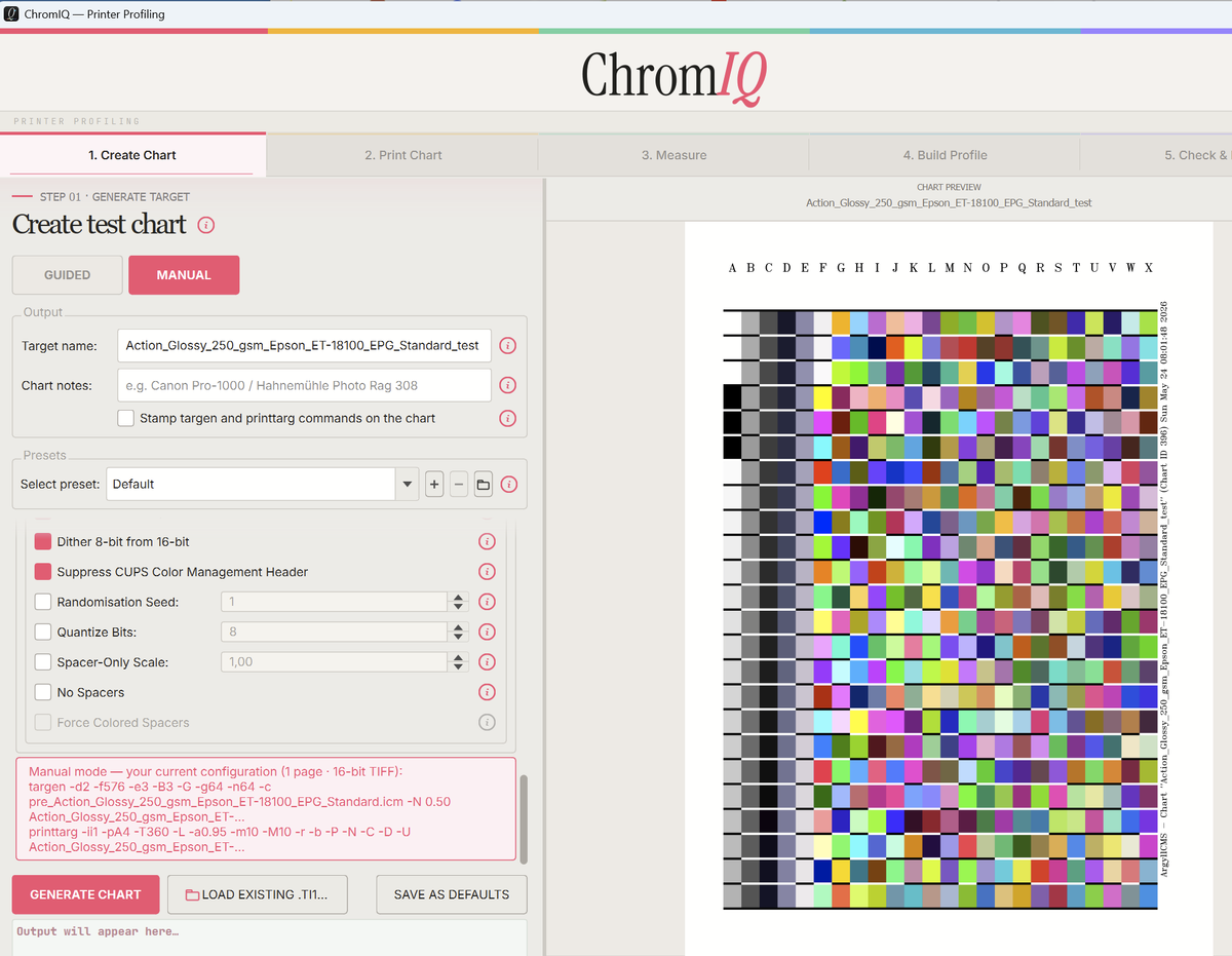

I am impressed. What I am actually doing now is a deluxe version of the Colormunki/i1Studio 50 + 50 patch method, but now I am using 336 patches for the initial profile/target and from the first reading it generates and estimates the neutral axis for which it generates new measure points to extrapolate and determine the final true neutral axis and corrects for the greys to be printed finally as good as possible to be truely neutral.
What do you use for the final targen command? I just printed a 506 patch set for my i1 Pro and will measure it tomorrow. I plan to do a three page patc set for the final profile (1518 patches) assuming I have no problems reading the one page at the 0.95 scale.
